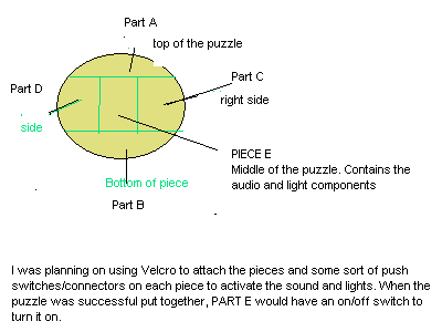

Crazymonkey,
I have attached a rough sketch. I hope it is better than my description.
Let say, I have a circular object. I want to cut the top and the bottom of the object in a circular shape. Then I want to cut the left and right side in a sphere shape. Then the middle piece is a rectangular shape that contains the circuitry. It is the piece that will have contact with all of the other pieces.
Do you think this is something that can be built?
Thanks for all your help!!
The Kid!!
I can't see any reason why it wouldn't work. Something to consider would be to use reed switches (switches activated by magnets) instead of push buttons on the pieces. They would make it harder to cheat.

All you would really need is 5 switches (1 for the on/off and 4 reed swithes to signal the pieces are together, all connected in series), a power supply (9V battery would work fine) and the lights/audio. What sort of lights/audio do you want? Flashing lights can be built using only a handful of commponents. You might also consder using fibre optics (be warned they are expensive) to use the light from the L.E.D's (in the centre piece) to light the outside pieces.
