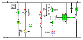

I'm currently in the process of designing a clap activated activated circuit. The circuit incorporates a 555 timer and is based upon a 555 timer monostable circuit , so that, using varying capacitors, the length of time for which the output is on can be varied.
The circuit works fine using an L.E.D. due its low power consumption: when you clap, the L.E.D. comes on for a specific amount of time (controlled by the resistor/capacitor network of the 555 monostable circuit).
However, I'd really need the circuit to turn a 9v motor on. If I just stick a motor in the place of the L.E.D., minus the 330 resistor, it just draws too much current, blowing up the 555 chip.

I've purchased two types of higher rated transistors (I can't remember the exact model number here - I'll try and add them later) but the circuit still doesn't work. When you clap the motor will come on for a second, or occasionally a few seconds before subsequently just stopping.
I've uploaded a creenshot of the schematic here:
So you can see the exact circuit I'm using (an L.D.R. is used in place of an electret microphone as croc clips doesn't have a microphone installed).
Any help greatly appreciated!
It is very hard to read. But looks like a RC in parallel with the LDR? Also, no base resistor. Is it and FET you are using, not a transistor? The 330 look low for going in parallel with the LDR, but again, it is too small for my old eyes.

With only 9V for the supply (it must have enough current to start the motor) the output high voltage of the 555 is only 6.5V to 7V. Then the emitter high voltage of the power transistor is only 5.5V to 6V. Then the loss through the diode causes a voltage to the motor of only 4.5V to 5V.
Your circuit doesn't have a supply bypass capacitor to supply some current to the motor when it starts. Use 1000uF.
Instead if you connect the transistor as a switch and use a series base resistor and connect the diode across the motor then if the battery has enough current the motor will get abut 8V.
Instead if you use a Mosfet replacing the transistor then the motor will get about 8.9V.

Without knowing the max current of your motor and without knowing if the battery can provide that much current then it is difficult to select a series base resistor for the transistor. Use 39 ohms then the output current from the 555 into the base of the transistor will be about 160mA and a BD435 or 2N3055 transistor will have a minimum output current to the motor of about 3A. The BD435 has an absolute max current rating of only 4A.
Here is your circuit with the transistor connected like a switch. I tried to make the schematic bigger but it gets fuzzy when bigger.
