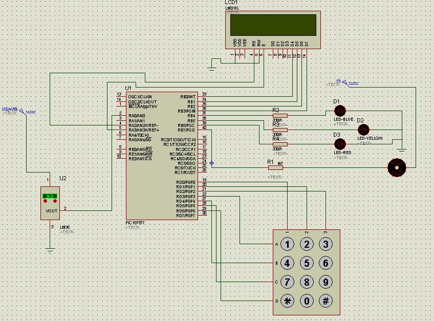

i wrote C codes but i need to know more. i want to connect 4x4 Numpad to enter set temperature.Like the example which i posted first and which made with assembler.
would you help me about it.

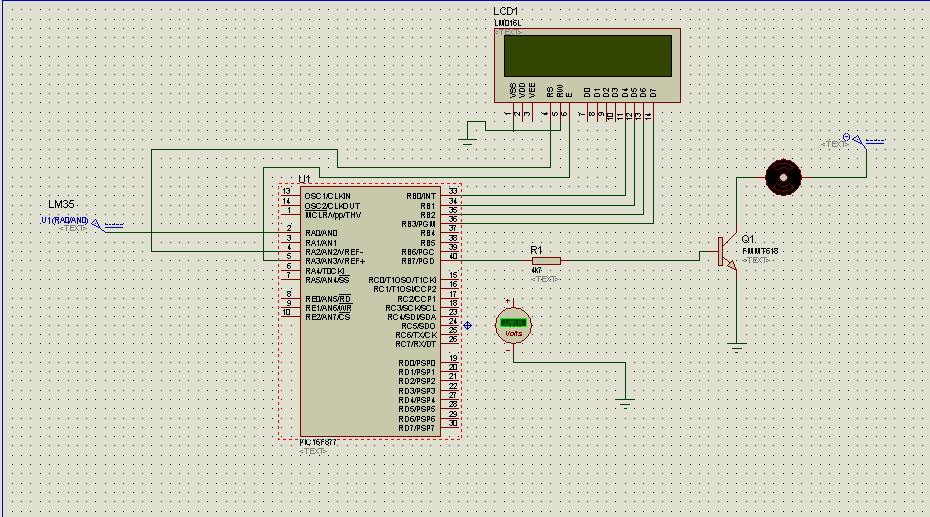

this is what i'm trying to do.
when the temperature below 20 degree blue led will be on.and motor is stop mode.
between 20 and 30 yellow will be turn on. when above 30 degree red led will be on and motor on too.
but there is something i want to add numpad..
click to star (*) enter a set temperature.if it is below from measured degree nothing gonna happen.but if it is above 5 degree motor will turn but if it measured degree is 10 or more degrees higher than set degree motor will turn more speedly.
i want to control speed of motor.
