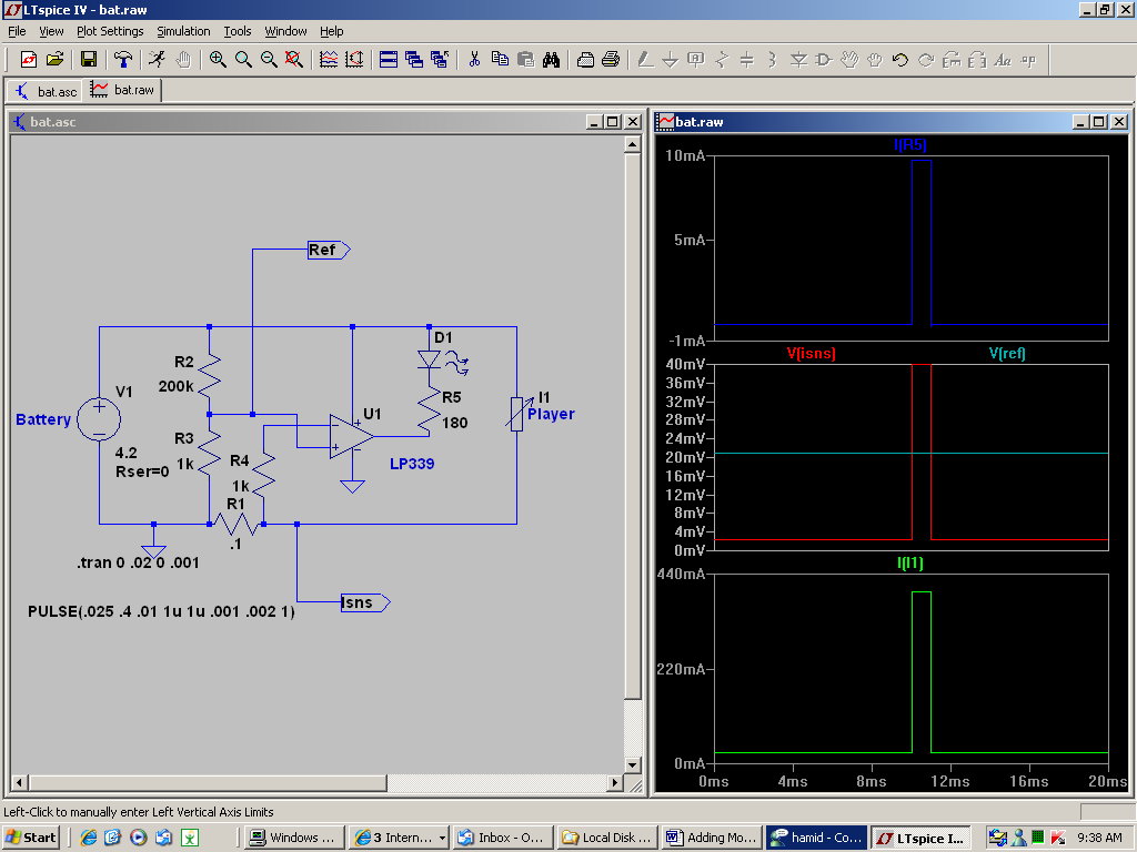

I need to have an LED turning on when there's current flowing through a device. Consider an electronic gadget, e.g. an MP3 player and its battery. This MP3 player draws approx. 25 mA in standby but hundreds of mA during operation. The LED (and its circuit) will be installed between the battery and the gadget and I'd like it to turn on whenever the gadget is not in standby, i.e. the current is above a certain threshold (let's say 50mA)
Some of the specifics are:
Battery: 3.7V to 4.2V, depending on charge
Standby current: approx. 25mA
Operation current: 75mA to 400mA
Desired LED current: 10mA (Vf = 2.8 to 3.0V)
Thank you!

what you are looking for is a comparator not a sense amplifier. https://www.electro-tech-online.com/custompdfs/2010/08/LMV7271.pdf would work ... using your battery voltage divided by 100 for a reference you get a sense voltage of around 40mV with a 25% inaccuracy depending on charge state and other tolerances.

So here is a simple comparitor circuit. Any low power comparitor should work.

So here is a simple comparitor circuit. Any low power comparator should work.
Thank you very much for this. If I determine that I need a higher current threshold, for example 100mA instead of 25mA, how would I calculate the new values?
The voltage is developed across R1 based on the current. E=IR. In the example .4 amps X .1 ohms = .04 volts. This is compared to the reference voltage developed by R2 and R3. I=E/R -- 4.2volts/201000ohms=.00002 amps. So the drop across R3 (the 1K) is E=IR or .0209 volts or the equivilent of .2 amps across R1. Change R2 to vary the threshold. If Isens is higher (more positive) than Ref. the LED will light.

I built some prototypes on flexible PCB; they fit nicely and work good... in fact, they work too good. That is, the LED lights up instantly as soon as there is some current consumption.
What I didn't realize when doing the initial measurements was that in standby, the phone occasionally draws high currents in very short bursts and these spikes make the LED light up for a fraction of a second or sometimes flicker. Therefore, I need to add something to this circuit that would introduce some kind of delay or otherwise smooth out the results.
I was thinking to connect a capacitor on the comparator's inputs (would it work?), but after some basic calculation I realized I'd need hundreds of µF and at it's hard to find small parts of such high capacity. What else can I do to obtain a delay with a smaller capacitor? Approx. half-second worth of "buffering" is all I need.
THANK YOU!
You can change R4 to 100k and add a 10Ufd. ceramic cap from the top of R4 to ground. The cap need only be rated for 6.3 volts so not to large but you won't find it at Radio Shack.

Nevermind; I ran the simulator and it looks sweet! I'm ordering the caps right now from Digi-Key and I'll be back with updates.
