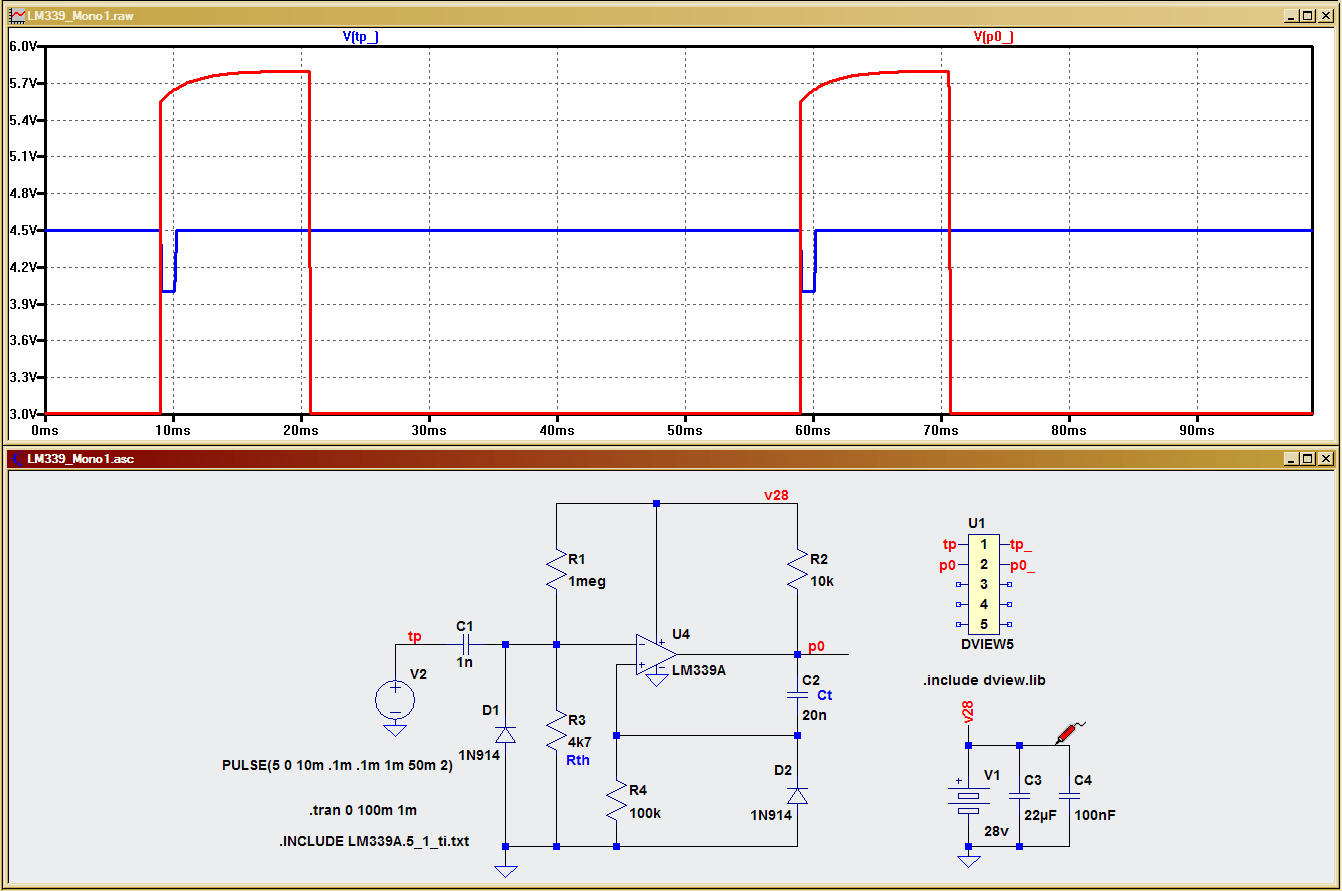

hi Mike,
The circuit using those components will not work with a 5V trigger pulse.
Look at this option, increase Ct for longer mono ON periods, Rth sets the trigger threshold.
I would use a 20Kpot for Rth.
What is the output pulse connected to.?
The output should be connected to another comparator's output thus "ANDing" them (open collector).
If that's not possible I could use a transistor for that.

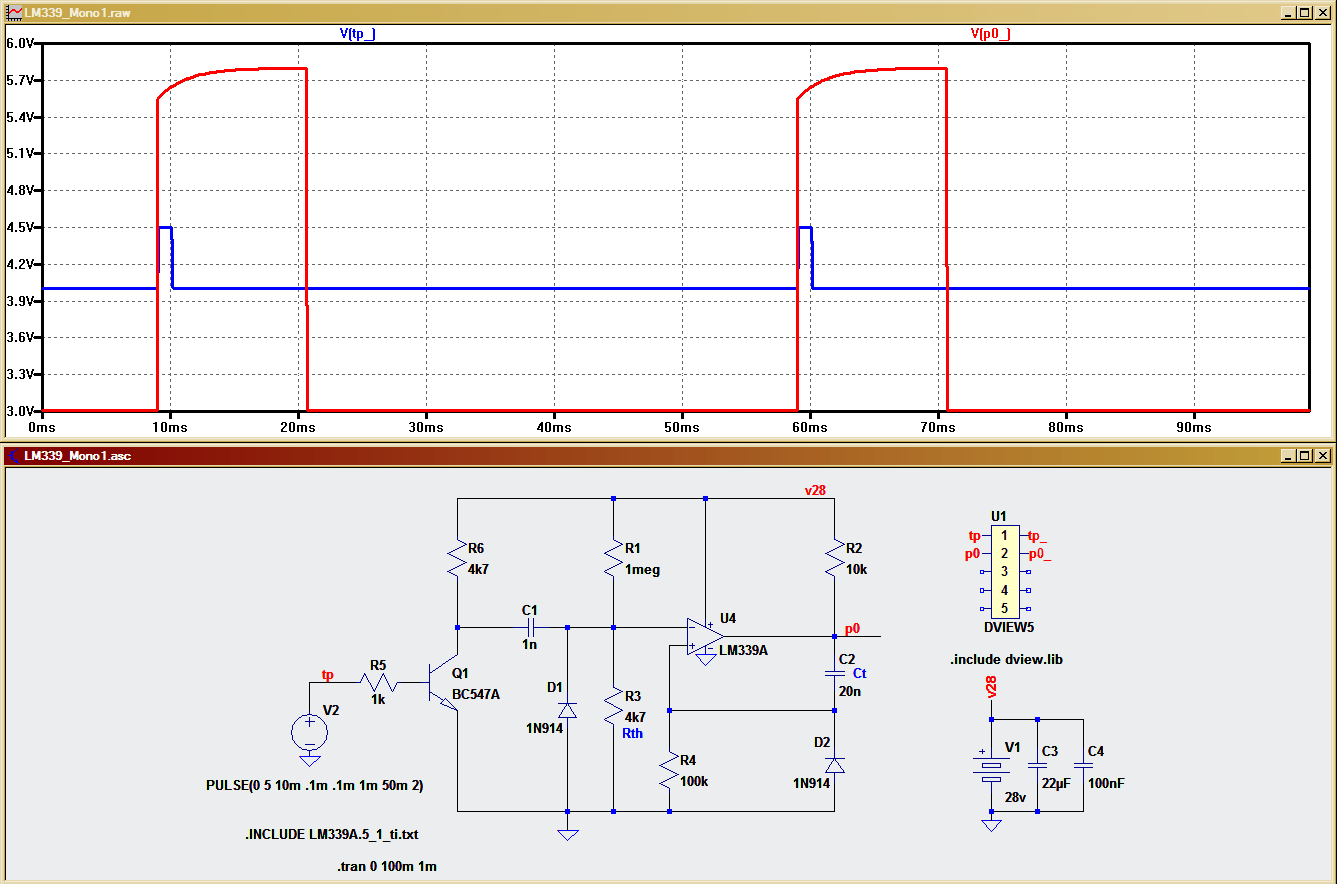

Also, what would it take to invert the trigger ? Currently it needs the trigger to go from high to low, what would be the easiest way of flipping it ?
The source of the trigger is an op amp.
And I still have one free comparator.
Thanks.
The simple way is an inverting transistor.

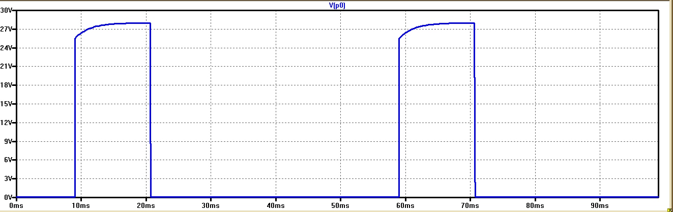

Also, one last question... this is more ltspice related.
Why does the output signal biased at +3v ? Could it be that the comparator model you use is bugged ?
I had that happen with couple of comparator models, untill i came a cross the model above in which the signal is not biased.

Its the 'dview' multi plot that appears to show an 3v offset.!
Look at this image for the actual pulse
Dont you use a the dview for multiple traces.
Actually I never heard of dview, im kind of new to ltspice.
I dont follow what you are saying.?

I got confused for what is the trigger soruce. I forgot it wont be a 5v analog signal but a 28v pulse.
That's why I edited the last post.
Anyways, thanks a lot.
Use a higher value resistor to the base and/or a resistive divider
