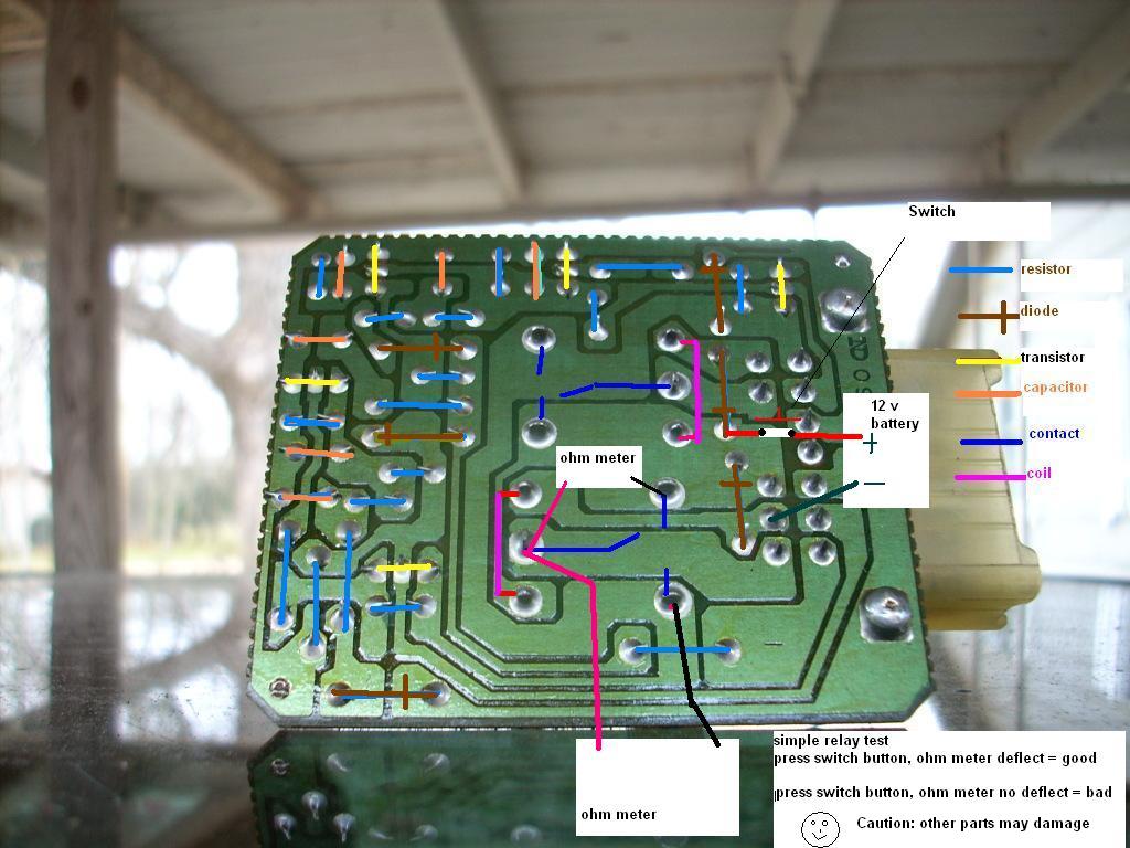

Ok, I have a retractor control module for my MR2 that needs trouble shooting/Rebuilding
I do have a spare I pulled from a parts car (also bad) so If I screw one up learning it's not as big of a deal
Here is my initial question
Is it possible to track down a schematic for trouble shooting?
If yes here is my next question
What information from the part do you need to assist me in finding a schematic?
I have already contacted Denso, and Toyota and neither of them are willing to give or sell me a schematic. Toyota wants to sell me a $160 replacement. But seeing as how I have a DIY attitude, limited budget, and am cheap. Id rather do it my self.
On that note I have also scoured the board and can find no obvious signs of damage.
I have also spent much time on Google and yahoo looking but to no avail. I am hoping someone here may have resources that I do not or just know a trick that I don't.
Than you in advance.
Pic of the part and all of the markings on the outside

It is not cast in epoxy, actually the only thing covering it is the plastic case. I will take a pic of the inside tommorrow and post it.

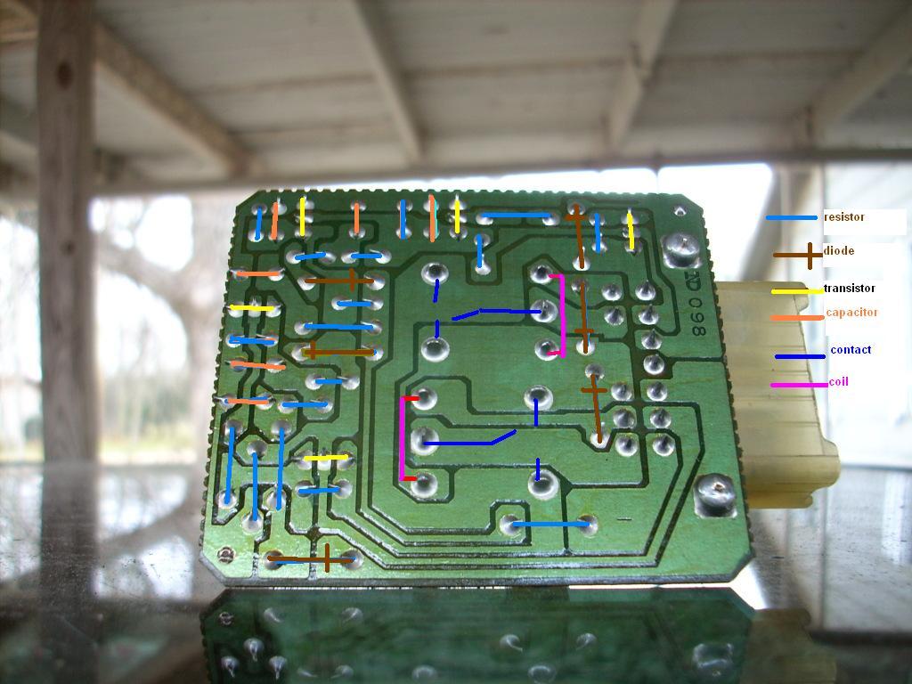

try to post photos of both component and solder sides with close up view. awaiting to see them.
Using my X-ray vision on the picture you provided I see a little black blob on the PC board. This is proabably an unpackaged custom circuit attached to the PC board and protected from the environment with the black blob. In this case you have virtually no chance of deconstructing the innards.

Additional info.
Nice photos Mad Electrician. I feel, by these photos you really helped yourself. rest of the work is simple.
jumides said:
Sure that you are going to post the circuit even, like you the overlapped photo with components on the solder side. Really Nice.

i have given tentative component numbers and perhaps The Mad Electrician can try to check and create a component list and post it. for that purpose i created a notepad list for him to fill up. both are attached.
However i expect some regulator chips like 78Lxx

Thats where I first began to look, here are the steps I took to diagnose and end up where I am at now.
Apply 12 volts to motors.
Pass
Verify that 12V is being transfered from RCM (RCM absent) Connection to Motors
Pass
Verify that Signal 12V is being transfered from switch in car to RCM Connection
Pass
Verify that 12V is going from RCM to motors
FAIL
How do I go about doing this? How do i identify (what they are) the individual components. I know the basics, resistor, capacitor, diode, etc. How do I break it down further than that?
By the way the only thing I have yet to do as far as testing goes is to finger the relays and see if they are still good. But there is no visible corrosion.

I'll lay odds if you force the relays to work the trouble will be the contact points -give them a clean and away they will go -

Done
See Zip for excel spread sheet If you do modify my sheets please update the version i.e. 1.0 to 1.1
Also on my resistor math if I have the formula correct please change the Verified column from No to Yes Hopefully I got this right
Now how do I do a search for the transistors/ semiconductors?

thanks, Let me do the rest wwof the work . I shall come back
jumides said:
hi The Mad Electrician.
mvs sarma will do the rest!!, and you do the test!!. :p
Hai Jumides, You were already half way and I only tried to continue after inspiration from your marking.
