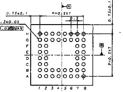

They works very nice, small and supply voltage is less than 3v! Even tiny mp3 players use them. My Transcend player has an incredible fm stereo reception that beats other portable types I ever heard. Here's a 48 pin-alignment of BH1403AGU.
