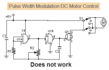

Watch out.
This one is just a variable frequency oscillator (Its pulse width duty cycle stays the same) that might change the speed slightly if its frequency is high enough to reduce the current due to the inductance of the motor:
