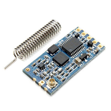

Example - an HC12 439 MHz RF module can be used with a PIC or Arduino etc. MCU; they are cheap and available worldwide:

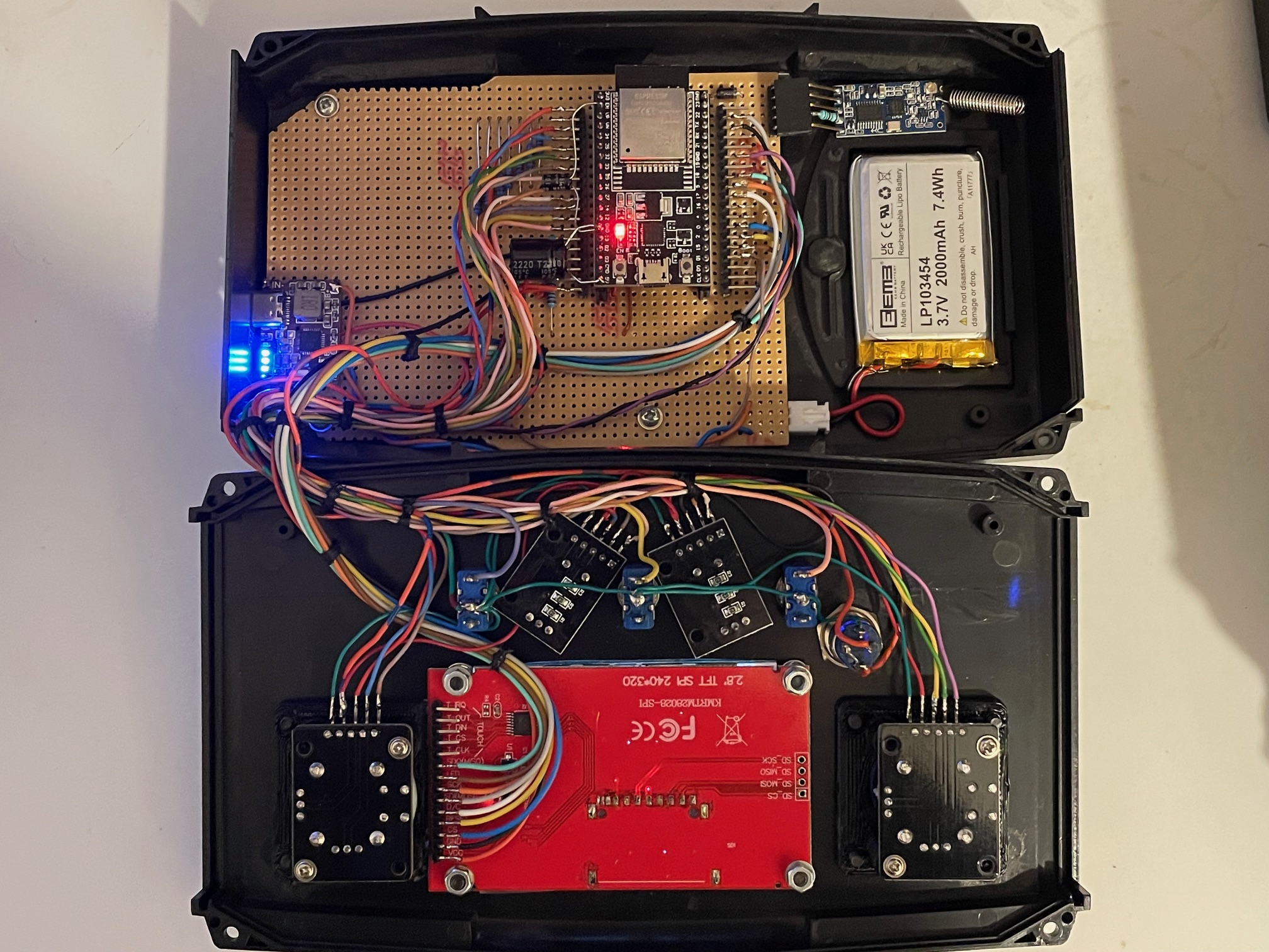

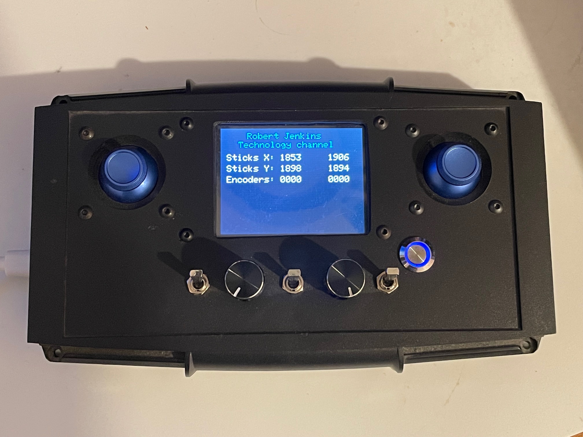

The ESP32-Devkit-C - again, readily available and with lots of analog inputs you can connect joysticks to.
This has a very fast MCU module and both WiFi and Bluetooth all in the one module.
They can also be programmed using the Arduino IDE.
I'm using one in this controller just for the analog channels, plus an HC12 for the radio link:
