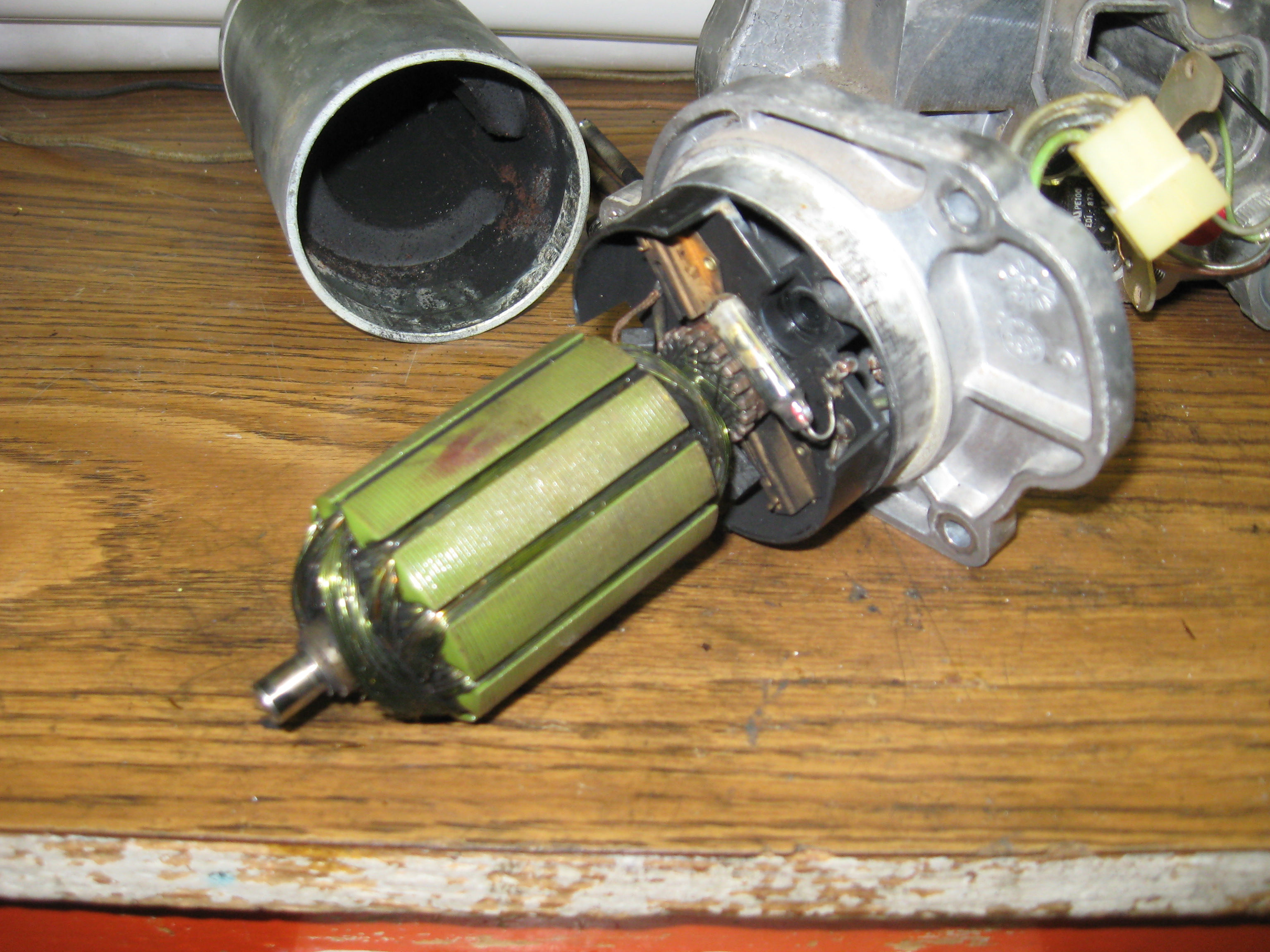

I have a defective cut out with part # ESB716C1L on it. It's made of clear glass and it's about 1 inch long and about 1/4 inch diameter and cylindrical. It has 2 leads coming out of one end of it. It very closely resembles a neon lamp in shape and size. It looks like it has set of contacts inside like a switch. The company logo on this device is a white triangle with a letter "s" inside the triangle and a lightning bolt diagonally on both sides of the triangle. It is used in a fuel transfer pump made by GPI that runs on 120VAC. The motor actually runs on DC as there is a bridge rectifier inside the pump assembly and this cut out is mounted inside the motor next to the brushes. Power has to flow through this cut out to run the motor. I cannot find any reference to this part number anywhere online.

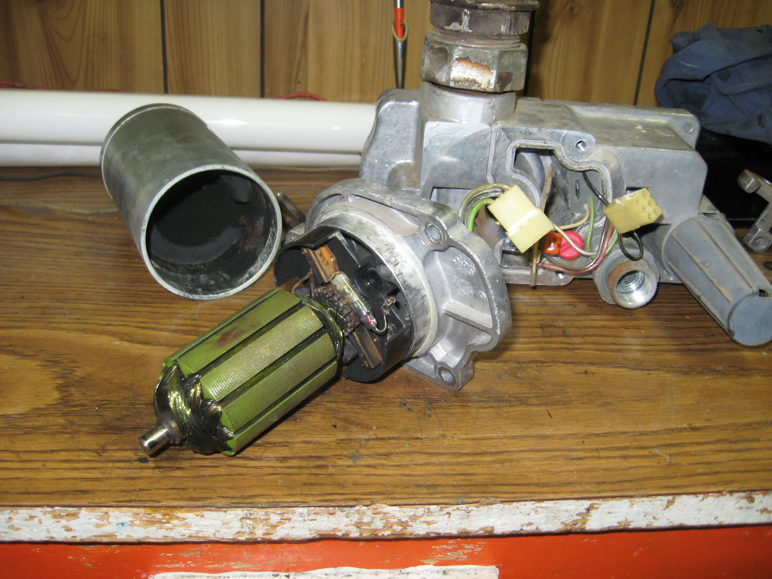

Hi, The pump is a GPI model 1100. I took 2 photos of the inside of the motor showing the cut out device. It is located alongside the commutator. The pump is in the second photo.

Although I have never seen a glass thermal fuse, the idea that it is one makes sense because it seems to be connected to the brush.
It may actually be glass because it absorbs the radiation from the commutator.
In the absence of finding one, I'd probably check the commutator with an ohmmeter and check the friction of the motor and jump the device briefly (with a fuse elsewhere) to see if it still works.

Now that you said two leads from one end, here is such a device: https://www.electronicsurplus.com/I...h_ temperature_ Thermal cut out_ - SB601AA1H/ but no specifications.
Hi, Thanks a million for finding the specs! Now I can replace the shorted bridge rectifier and get the pump fixed. I tested the motor and it works fine after I bypassed the cut out.
