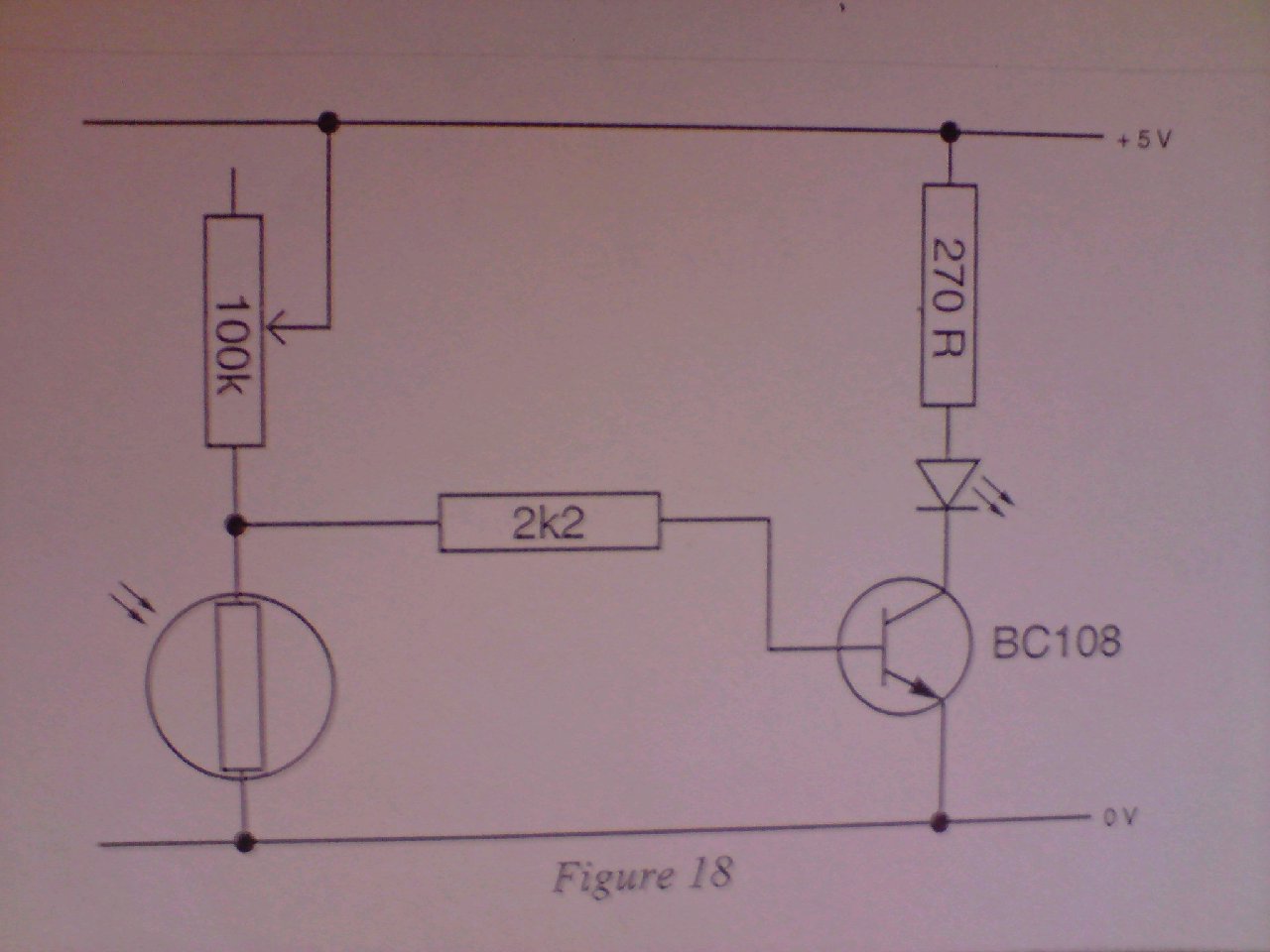

heres the circuit diagram i have to construct but i dont know how it works and what components do what:

cool, but know i know what everything is what do they all do,im still confused.Please can anyone help?

Ok,
100k is a Variable Resistor, it's resistance can be altered by turning the shaft. It's resistance can be anything from 0 ohms to 100K ohms depending on the position of the shaft.
The symbol below that is a Light Dependant Resistor (LDR). It's resistance will vary depending on how much light (or dark) it is exposed to.
Look here for a better explanation : Light Dependent Resistors
The BC108 is a transistor, in this circuit it is used as a switch.
The link above actually uses a circuit similar to the one you have (but it has 2 transistors connected as a 'darlington pair', don't worry about that)
You also have a 220R resistor (220 ohms, some people tend to write R instead of ohms)
You also have an LED (Light Emitting Diode)
The link to the website above should tell you what the circuit does.

Thanks thats brilliant, just what i needed, one other thing the resistors in the circuit are in place to just limit the amount of current flowing to the next component right?

Right (for this circuit), except for the variable Resistor. The purpose of the VARIABLE resistor is to set the sensitivity of the circuit (ie, to alter the amount of light needed to turn on the LED)
