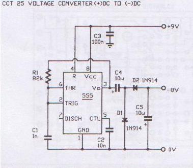

maybe this. dunno about current, but i'm sure you can use 12VDC with a 555.

Look at the LM2611. It will do +12 to –12 conversion with few parts. Only 200 to 300mA. Small!

You could bais the 0V nodes at half the battery voltage but some of the resistors are a little low for that. Another option would be to use another op-amp like the 741 configured as unity gain buffer with the input biased to half the battery voltage and 100nF capacitors connected between the output and the + and - rails.
