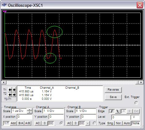

I have redesigned this oscillator using LM6181, it seems working, but there is distortion on the wave form, and the output power is only about 23mW. Is there any correction can be done on the circuit to perform better? Or any other op-amp can be used for this case? Thank you.

Now you have a very fast current-feedback opamp with a high output current. But the level stabilizing diodes are clipping the top and bottom of the waveform.
If you reduce the opamp's gain to be only slightly higher than 3.0 then the distortion will be reduced but the oscillator will take a long time to reach its final output level and one day might not work.

So, should I remove the clipping diodes? The gain now is around 3.03 (1k/330). Is it hard to get the desired wave form in practical? How about crystal oscillator?
If you remove the diodes then the output will increase until the output of the opamp clips.

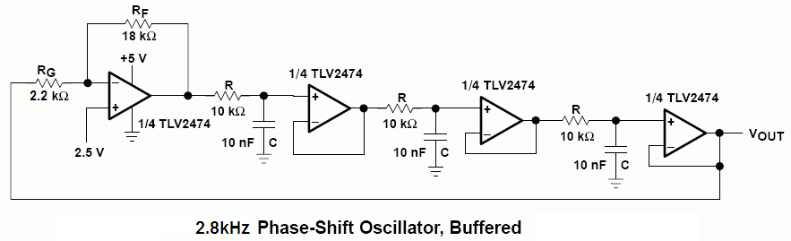

I made a low distortion sine-wave oscillator as a phase-shift type.
A resistor in series then a capacitor to ground creates a lowpass filter with a 60 degrees phase shift. It is buffered with an opamp then feeds another and another to make a total of 180 degrees phase shift. The last one is buffered and is the low distortion output which is inverted by a 4th opamp that clips and feeds the input.
The 3 lowpass stages reduce the clipping distortion to nearly nothing.
The lowpass filters have a little amount of loss that can be made up if the opamps have a little gain.

Texas Instruments have a phase-shift oscillator for 2.8kHz that has a low output level because its buffer opamps don't have any gain.

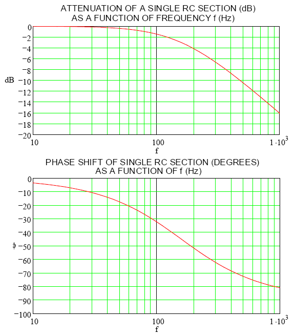

3) Each 60 degrees of phase-shift reduces the level by about half. So the gain of the inverting opamp needs to be a little more than 8.
