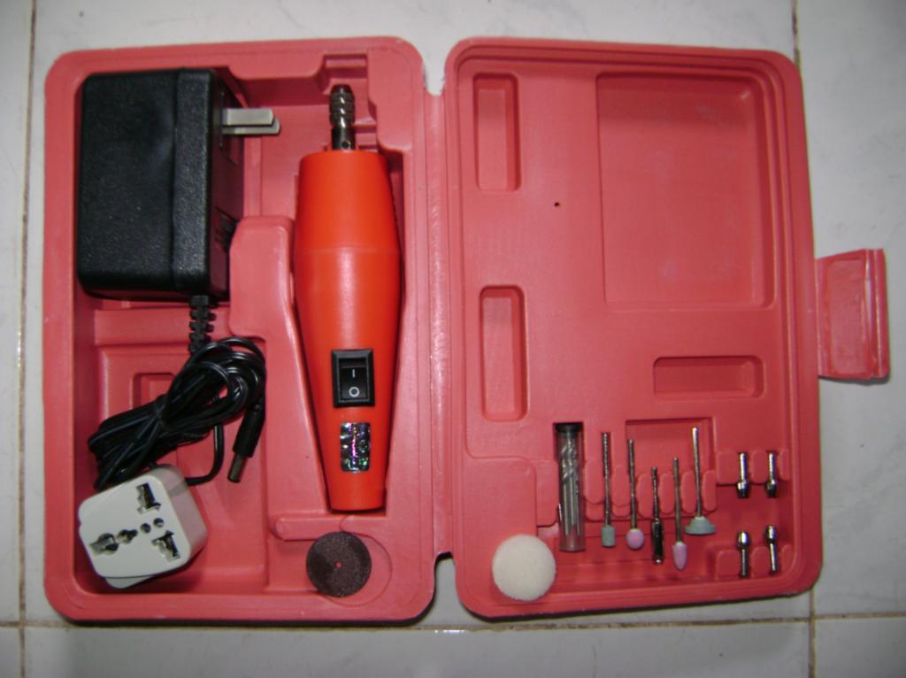

This is my very basic PCB drill helped me to make millions of holes.
Hi Hans,
I change tools as little as possible because it is too easy to break them. Most of the time I use a single drill for the entire board.
One could not use a multi arm setup on a XYZ cnc mill. But by the time you add the arm and electronics I am not sure it would be reasonable. It would take a longer X axis to do the same work. The only software change would be to add a different offset depending on the arm in use. Easy if the software has provision to make such an adjustment during tool changes. Or if on had the source. Maybe a better method would be to generate Gcode and then process it to add the offsets.
On of the problems is lash or play in gears and screws. If one always approaches the target from the same direction it is better. Also if one were to provide a slight load in one direction it would help.
