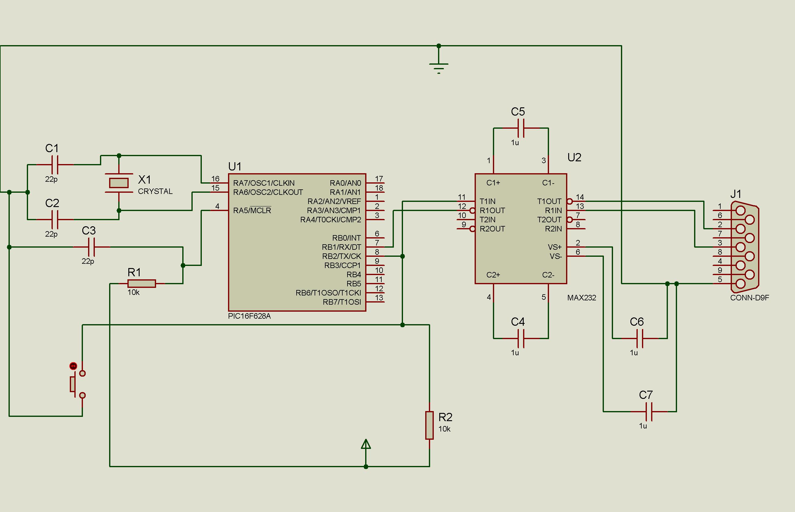

here is my schematic and the code i am using....
plz note that in my schematic instead of using a movement sensor i used a switch...since i couldn't find a sensor in ISIS.
and i think it is correct because the sensor when detecting will close its contact, so what i am doing is when the switch closes i need to send a signal to the pc...
if there any clarifications plz ask me..
thx a lot for your help...
PS : the code written is meant to test UART...when trying to run on ISIS i keep getting this error "no model specified for J1 " (the DB9 female) i have no clue what this means.

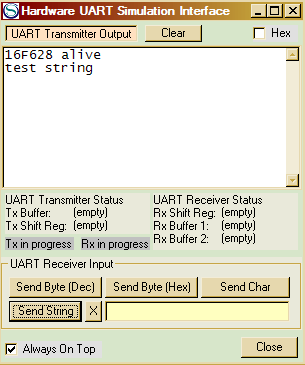

hi chantal,
Tried your asm in Oshonsoft, it runs fine.
Ref the image.

i have posted the schematic and the assembly code....i need to modify the code in a way that as long as the button is pressed i will be able to recieve a msg (for example on or anything else) on my pc. in other words i want to keep recieving "on" untill i release the button....is this doable?
thx for ur help and ur time
Regarding your ISIS issue, click on J1 and select "Exclude from simulation" from the check box list.
Regarding your original issue, if you need to detect just one sensor, you can (if your particular chip has the feature, and I am 99% sure it does) use RB0/INT to pick up on the interrupt, which will "interrupt" your code and process the button / sensor state immediately.
