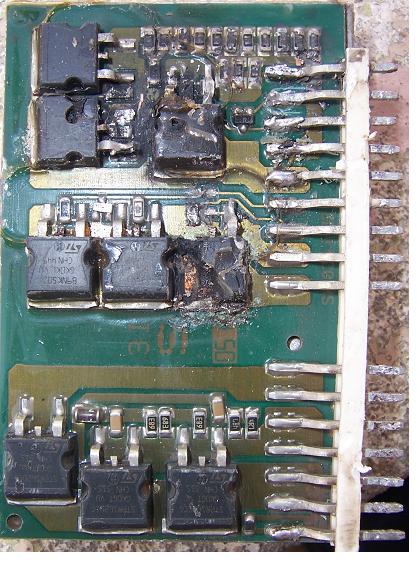

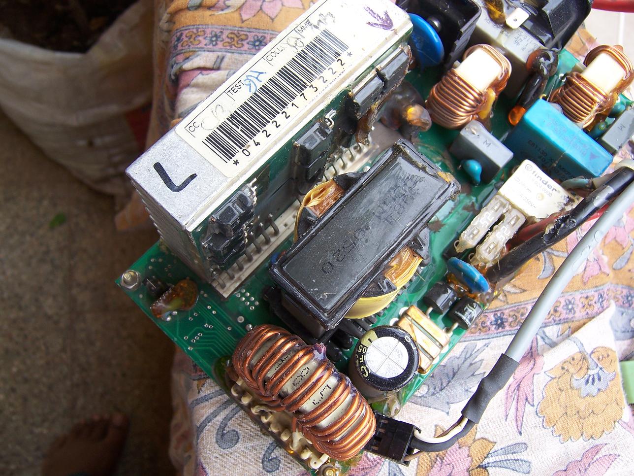

need help in replacing mosFETS onan Aluminum pcb of a battery charger.
mvs sarma
I am attaching two photos of a pcb sub module on aluminum
Please suggest any method , how to remove and replace, as available 120watt iron rendered useless. the part of pcb is split from the heat sink, but has Al base. Thanks in advance.

If I understand correctly, the PCB is quite thin but has an aluminium substrate or backing plate.
How is the "body" of the mosfet fixed to the PCB?
Do you need to re-use the mosfets? if not just cut off their legs and try again with your 120w iron to remove the chopped leg from the PCB.
Could you heat up the PCB backing plate by putting it on a hot plate while using the soldering iron on the mosfet pins?

the MOSFET is soldered as it is Dpack package. even the dual diodes are also similar
You will be lucky to get them off. Its a Thick film unit & not meant to be repaired but replaced. The mosfets will be very hard to remove without damaging the rest of them as the aluminiumn heat sink is removing the heat as designed to do. It would have had the components fixed to the PCB first then the assembly glued to the heatsink. Seen this type of construction in Hitachi tvs back in the early 80s in the vert def.

That unit looks like it needs "fixing with a new one"!
Well fried!
I solder parts in a toaster oven, and some times unsolder parts there.
I hope you can remove the aluminum. If not you will need to get the aluminum to the milting point of solder.
Place the board in the oven. Put some pieces of solder on the aluminum (or PCB)so you can watch for when it reaches temperature.
