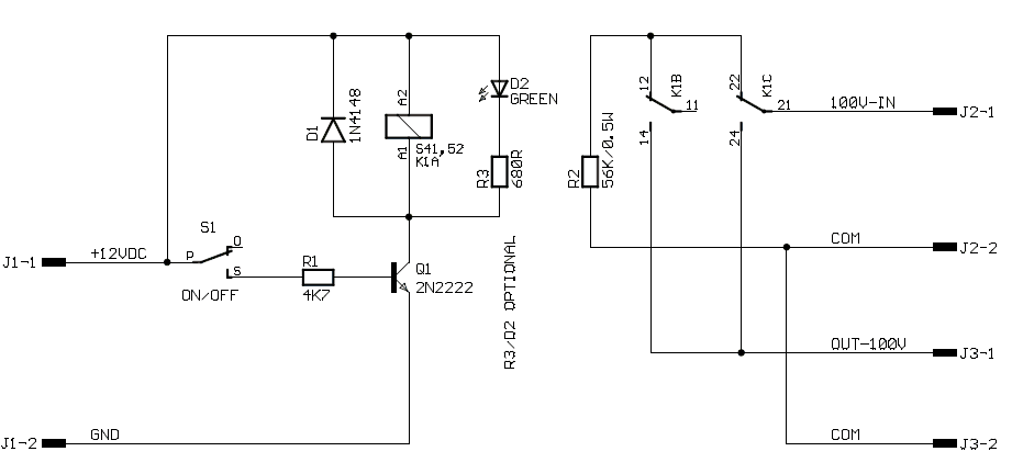

I guess the problem is the inverter. Interrupting the 100V line the inverter continues working producing overvoltage with no load connected.
You might interrupt the primary side. If it takes too long time for the inverter to start interrupting the 100V output will suffice if you keep the interter working with a load connected.

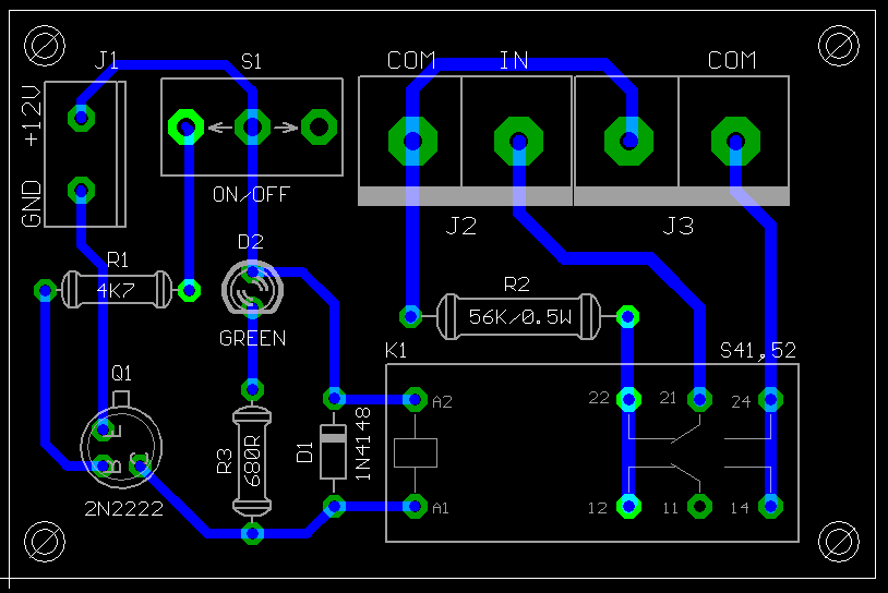

Here is a suggestion how to switch the inverter output with a load resistor connected via the NC terminals of the relay. The current fow will be 1.8mA, taking care of no overvoltage.

Hi projectman,
my suggested circuit leaves the inverter running, no matter if you connect or disconnect the load.
When no load is connected and the relay is in the NC-position R2 (56KΩ) is the load the inverter has to drive. That resistor takes care of sufficient current flow if no "real" load is connected.
Switching the relay to the NO position the connected load is driven by the inverter.
Disabling an unregulated inverter might cause high voltage spikes when energized. R2 takes care of spikes not being stronger than the rated voltage and current of the inverter.
More or less you leave the inverter operating at all times and just switch different loads, one being a "dummy" load (R2) and the other one the real load (led stripes).
Boncuk
P.S. I forgot to draw one connection at the relay. Terminals 11 and 21 have to be connected for higher current flow. They are located in a straight line on the PCB.
Thanks again, Boncuk. I've thought about that approach and didn't pursue it because I didn't know how to make the dummy load. You may be right that flipping the inverters on and off could create a power spike and damage the el-wire. I would really like to understand how to build your circuit, but I can't interpret the diagram. I can tell what the battery, resisters and diode are, but I really can't tell what is what. Perhaps "K" is the relay, but which side is NO or NC? I have no idea what Q1, J2, J3, D2, or S1 are. I'm used to diagrams using symbols like this: https://www.arrl.org/tis/info/pdf/8402019.pdf. Do you have a link to an article that would decode the symbols used in your diagram?
