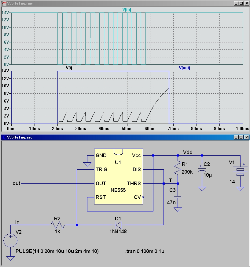

need help making a circuit to sense PWM on 12v auto headlight (DRL)
Paiko
ok... what the problem is that the daytime running lights (DRL) on the new cars are using PWM for dimming the headlights during the day (full 12v at night)... i do not know the frequency and i think the voltage drops down to about 10v (under load - do not know unloaded)
i need the full voltage to run the ballist for the HID lighting...
i have used the signal to gate a SCR and run a relay that supplied the HID's
what i want to do on my truck is use that DRL signal to turn on a relay that turns on the fog lights and when the DRL signal goes away (full 12v) the same relay drops out and i can light up the HID's
not sure how to do this.... any ideas???

How about using a 555 as a retrig monostable missing pulse detector. While the PWM is present, the output of the 555 is high. When the PWM is gone (input steady high), then the 555 output is low.

hey mike, thanks for the circuit... just finished making it and tested it on the truck... so far so good.... now i have to setup the relays to cutout the pulsing voltage to the HID's and hook up the HID's
Back to the OP's topic. I am an extreme novice.
Pin 1: self explanatory
Pin 2: is receiving signal from V2 ( the bcm outputting a pulse width signal or a constant 14v signal). It is also receiving current from Pin 7 AND from Vdd, via R1. I am not sure what the signal from Vdd is doing.
Pin 3: This is the output that outputs 12v? when Pin 2 goes "low" (less than 1/3 Vdd?), otherwise it outputs nothing? when Pin 2 goes "high"
Pin 4: tied to Vdd to prevent accidental reset...
Pin 5: Left open. Why is this not tied to ground via a capacitor?
Pin 6: Threshold: Receives signal from what appears to be Pin 7 and Vdd via R1. Again, not sure what's going on here.
Pin 7: Outputting signal to Pin 6 and to Pin 2. I understand this pin also works as an auxiliary output. When Pin 2 goes High, Pin 7 goes low?
Pin 8: Takes in Vdd.
Question:
What is the other side of of C3 and C2 hooked to? Ground?
So how does the OP use this then to trigger Light A when the PWM signal is on, and trigger Light B instead when the PWM signal disappears? Im sure the answer is right in front of my nose but I just can't seem to totally understand the process.
Help?
When the TRIG input is pulled below 1/3 of Vcc (4V), the 555 is "triggered", meaning its OUT pin goes high (near 12V), and the DISCHarge transistor (pin 7) is turned on, discharging C3 to near ground. This happens as long as the PWM input is low...
It outputs either almost 12V (high) or almost ground (0V, low). It can source or sink about 200mA
To disable the RESET pin, i.e to prevent it from doing anything...
You can if you want to. The simulator doesn't care. A real 555 might.
When the PWM signal goes high, the RESET condition goes away, turning off the DISCH transistor. Now Diode D1 is reversed biased (blocking), so the timing capacitor C3 begins charging through R1. If another PWM pulse comes along before the voltage at Pin 6 THRS reaches 2/3 of Vcc (8v), then the 555 is triggered again (re-triggered?). If PWM stops high, then the 555 times out, Pin 3 OUT goes low, the lack of PWM is detected, job is done...
See above.
Question:
All the upside-down Δ symbols are ground, and are all implicitly connected together. Just short-hand in lieu of connecting them all with expicit wires in the schematic.
Help?
The 555 OUT pin3 is capable of sourcing or sinking about ~200mA. It can drive a small 12V relay directly (with a snubber diode across the coil), or by adding a NFET or PFET transistor used as a power switch, could switch 10s of A. Here is a similar circuit that shows the 555 driving a relay.
