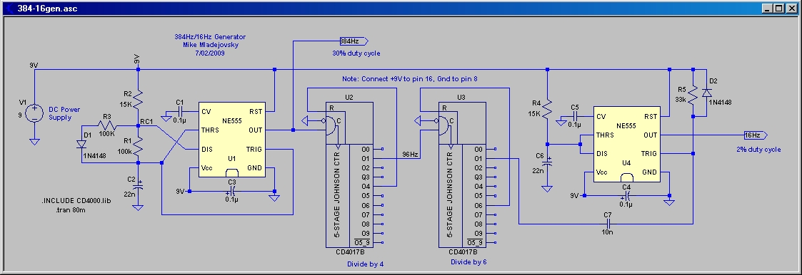

The best way to do this is to make the 384Hz oscillator first (probably using a 555), and then use a divide-by-24 digital counter using CMOS logic to create the 16Hz signal. I dont have time right now, but later today I will come up with a schematic if this will work for you.
I'm with Mike. The divide-by-24 digital counter is the way to go. It's stable and no tweaking required except, perhaps, to adjust the 384Hz frequency.

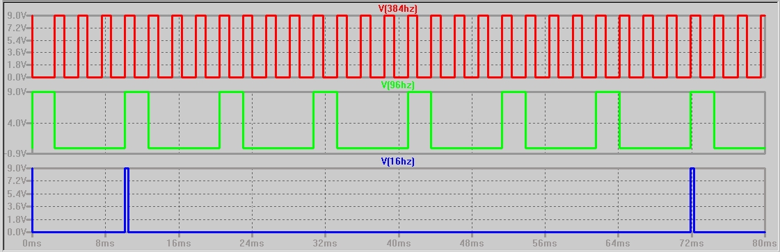

Stare at this. 555s and 4017 counters are readily available.
hey thanks this looks awsome! and i recon i can build it no problem, will it run on 12v?
Yes, it will run on voltages up to 15V, but I would not go higher than the resting voltage of a lead acid battery, say 12.6V.
thinking further about it, the whole thing needs to be slowed down to about half or even less 160 - 190Hz is perfect, the camshaft turns at half engine speed so the syncronising puls is only read at every second engine rev
The left 555 determines the running rate. Making C2 47nF will slow it down by a factor of 22/47= 0.46, so you will get about 180 Hz, while still preserving the 30% duty cycle. If you vary only R1 or R3, the frequency will change, but so will the duty cycle. If you want to preserve the 30% duty cycle at each new frequency, either change the capacitor, or you will have to change R1 and R3 at the same time.
what variations will this require and can we make it adjustable with a variable resistor without upsetting anything?
Unfortunately, to get a 30% duty cycle out of a 555, you need the funky second resistor/diode in the 555 timing network, which means varying two resistors simultaneously. A ganged dual-pot would work, or adding a new divide by 3 counter (just to get a digitally derived 33% duty cycle) and running the 555 at 3X the frequency would work.
lastly can i get different divider intervals by simply using different pins from the 4017 counters? again without upsetting anything, this would be handy for engines with different numbers of trigger teeth.
Yes, the first divider can be strapped to divide by 1, 2, 3, 4, ..., 10, and so can the second divider, just by moving the feed back tap that goes to the R (reset) input. This means you can get any total divide ratio which can be expressed as the product of two integers from 1 to 10. For example it the first divided by 7 and the second by 5, you would get a total divide of 35...
Just a further thought looking at how those counter/dividers work, can we do away with the second 555 circuit? the duty cycle is not critical so can we reduce the primary duty to about 20% and then just use that output straight from the counter for the secondary output?? and will it have the same duty time as the primary signal but every 24th puls as required??.... am i making sense???
The natural output duty cycle of the divide by 6 counter is 1/6=16.6%. If that will work, you can eliminate the second 555. However, the CMOS output of the counter will not drive much of an external load, so depending on what the 16Hz pulse is connected to, you may need a "buffer" of some sort. The 555 as shown will drive ~ 200mA. The naked CMOS output will only drive ~ 2mA, which would be a 6KΩ resistance or higher.

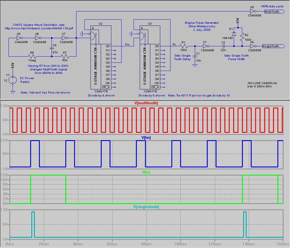

Here is a modified circuit. I removed the 555 oscillator and replaced it with one that has a 50% duty cycle over a wide range of frequencies. See here for an explanation of how it works.
Since that left a couple of sections of the hex inverter/buffer, I added a pulse delay and a pulse width circuits to the final SingleTooth output so that its edges are not coincident with the MultiTooth signal and so that it was narrow. You can play with the R and C values in this section to move those edges around.
The 4049 has more output current than a standard CMOS output, so the two outputs should drive your ECU. New circuit and simulations attached, including the close-up of the relative timing between MultiTooth and SingleTooth.

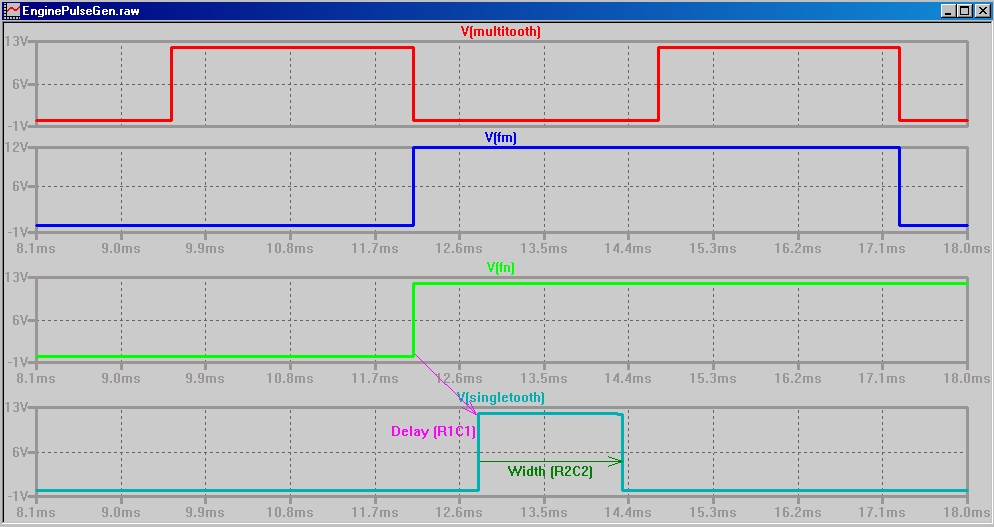

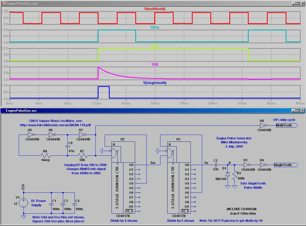

Here is another tweak. The rising edges are not coincident. I left the pulse width circuit to shorten the SingeTooth signal to less than one MultiTooth period. If you dont care about that, and you could use Fn as the output, you can eliminate D1, C2 & R2, but leave both inverters in the path from Fn to SingleTooth to buffer the signal.
Put the caps right across Vdd and Vss on each IC.
