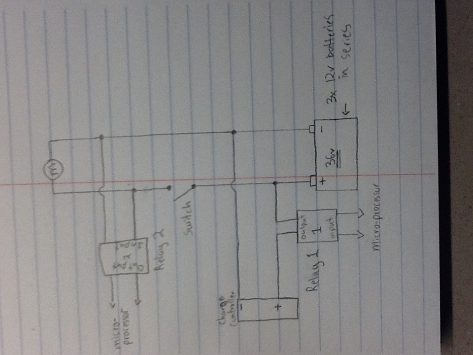

I attached a quick sketch I made for this circuit, hopefully it gives a slight idea of what I originally had in mind. Since I have a microcontroller I was going to use that, but if it's easier to do without it, I'll use another approach.
You definitely do not need a microprocessor to accomplish this. That would be like using dynamite to swat a fly.

Actually, I think all you need is this:
All you really need to do is to disconnect the motor when you're charging the batteries, correct? You have to disconnect the charger anyhow to use the mower, as stated above.
Unless I'm missing something here ...
After thinking about this a little more, you could also use this circuit in reverse, if you want to leave the charger permanently connected: just connect the left side (labeled "to charger") to the mower motor, and wire the relay contacts to the charger to remove it from the circuit when the motor is on.

Obviously you'd have to put this together; you can't go in a store and buy this. But it's so simple: just a single relay wired to the mower parts.
So your charger can stay on the mower while you use it? I guess you did say it was operated from batteries and an inverter. But isn't that a lot of stuff to drag around your lawn while you mow it?
I'm referring to my relay circuit. That's really all you need here; you need to disconnect either the motor or the charger, depending on how you rig this.
