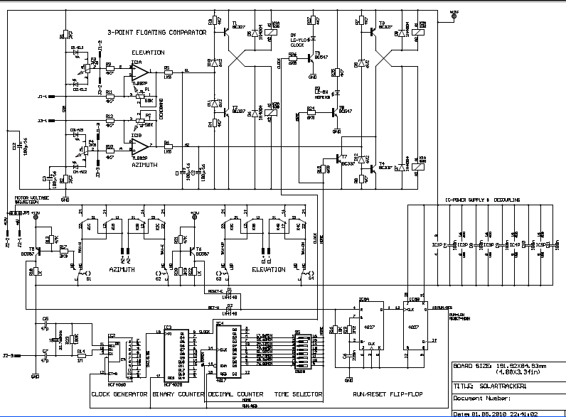

the circuit works but I am not that well versed in op-amp configurations. I am using two GaP led sensors (4 LEDs in paralell on each input) which feeds a voltage comparator which in turn drives a push/pull transistor pair (think thats the correct term) which gives directional control to a dc motor. The circuit works well but I have a problem in that the voltage output of the op-amp swings positive to slowly causing the circuit to use more power than I think it should. The circuit is designed to be very simplistic and I would like to keep it that way (as few components as possible)
sry I guess I should post some component values... 4558DX General Purpose Op-Amp, D2058/NTE377 NPN Transistor, B601/NTE262 PNP Transistor, Zener Diode - 5.6v, R1 - 10meg, R2 - 5meg, R3 - 20k-ohm, R4 - 10k-ohm, LEDs - clear lens GaP green 5mm 40deg, power supply 24volts (+12/-12)
You can't have that diode on the motor, it'll forward-bias when the motor's reversed. You'll need to move that protection over to the transistors themselves.
The circuit's theory has problems. Motors should generally not be controlled by an analog voltage like this. It's inefficient, heats up the transistors, and tends to stall the motor.
What you need is a comparator with 3 states- forward, reverse, or nothing. And there needs to be some form of hysteresis to keep from oscillating between forward and reverse, hunting for something "perfect". The Stop state needs to exist for MINOR imbalances in East/West signal, because when you stop when equal, with high gain, minor fluctuations in East/West signal will cause it to be in constant, pointless motion. More like "ok, if East is SIGNIFICANTLY greater than West, move Forward, then Stop once East isn't SIGNIFICANTLY greater than West. Even if West becomes slightly greater than East, don't start moving Reverse for that".
Thanks Oznog ... the circuit has to be as simple as possible ... it may not be ideal but it works... the diode on the motor was a mistake I will update the schem... I am looking for some suggestions on how to modify it to overcome the shortfalls you have pointed out.
The circuit also has another fundamental flaw. Read Rule of thumb #3 in this**broken link removed**

I cant see how the circuit broke rule#3 as the LEDs are operating in solar cell mode as voltage generating devices?... interesting idea placing the LEDs in a inverse parallel configuration I think I will def give that setup a try... maybe feed it into a flip/flop op-amp arrangement... you also have to remember that the sensor also must reset the tracker to east in the morning and be able to regain alignment after cloudy periods...

Here is a minimalistic solar tracker.
It controls azimuth and elevation and contains a homing circuit with a timer to select duration of twilight up 60 degrees latitude.
