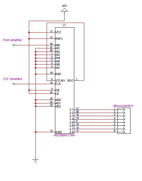

im now using the adc0808 to convert the human voice into the digital form. but there is no output shown?? why??
where is the problem??
thanks for ur help
yes im using basic stamp 2
but is not the bs2 problem.
the adc will give me all output high although i didnt put any signal in..

What are you using for the clock signal?.
Also, you appear to have it wired to continually convert, as you are using a micro-controller you should use a signal from that to initiate a conversion, and wait for the end of conversion signal.

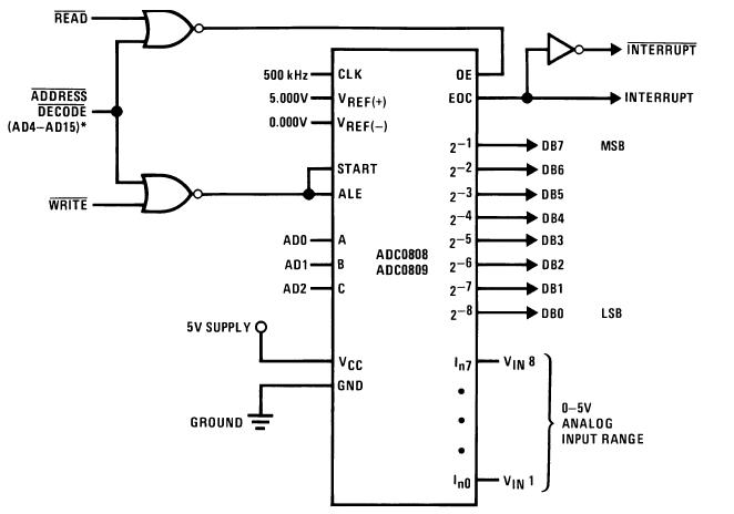

two things..
1) the 0808 has no sample & hold circuit built in.. so you may want to use a different ADC.. or add one yourself..
2) as Nigel tried to tell you the interrupt ( or EOC ) is supposed to tell the uController when the conversion is done..

Just curious ... Does the BS2 actually run fast enough to handle 7K samples/sec?
