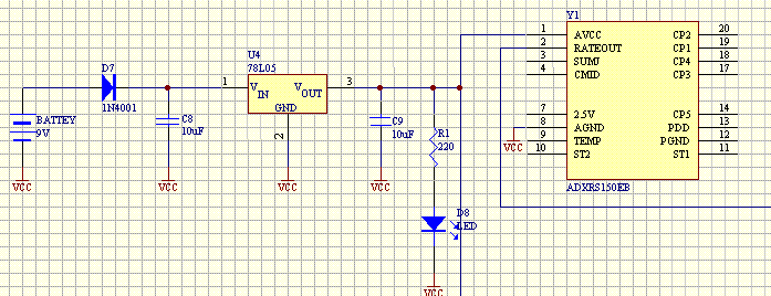

first of all i would like to say thank you for viewing my post of help. i am a newbie and i was ask to do a project on using the electronic gyroscope of adxrs150eb (by www.analog.com) to be interfaced with pic16f877. i am using the crystal oscilator of 20 mhz. the problem is, is my circuit of the adxrs150eb (as attach below) is adequate enough? i connected the RATEOUT pin to the AN0 of pic directly. the adxrs150eb is equiped with predefined capacitor.
reading through the datasheet is not adequate enough. so i kinda need some help from you experts out there. i think there should be an op-amp there right? which are the best? please help.
and the a/d for pic16f877 need to calculate the acqusition time. i was dumb calculating using the equations given in datasheet. please help!

I don't know anything about the adxrs150eb, but (from your post) I presume it outputs an analogue voltage on pin 2?. What is the range of this voltage? - the default range of the PIC is 0-5V, but I use an external voltage reference in my tutorials to make it 0-2.5V.

the adxrs150eb is actually an electronic gyroscope as when it senses a tilt, it will give out an analog output porportional to the tilting. meaning... no tilting gives around 2.5v. the output measures from 0 to 5v. do i need to have something to let it act as an interface between the pic and the adxrs?

You should be fine connecting directly to the PIC, although a series resistor may be a good idea (just in case), a 1K would be fine. Use the PIC A2D as 0-5V, using the Vdd rail as the +ve reference.
