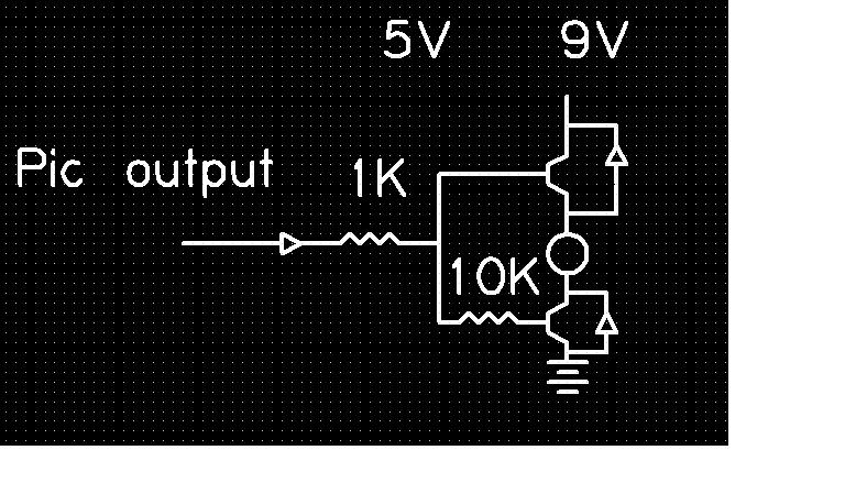

I attached an example circuit from "Pic Microcontroller Project Book" by John Iovine. Its only half of the bridge but shows what I was refering too as the low side having a higher resistance in the current limiter then the high side, unless Im confusing the operation of the circuit. Both transistors used are 120Tips.

In this circuit the lower transistor is used as a switch, the top one is placed as emitter follower. They're diffirent usage of the transistor, that's why the base resistance isn't the same.
The top transistor won't switch, it's emitter will follow base voltage (minus Vbe). As a result it will also dissipate more heat.
If you want both the top and bottom of the bridge to switch, then you need a PNP at the top.
