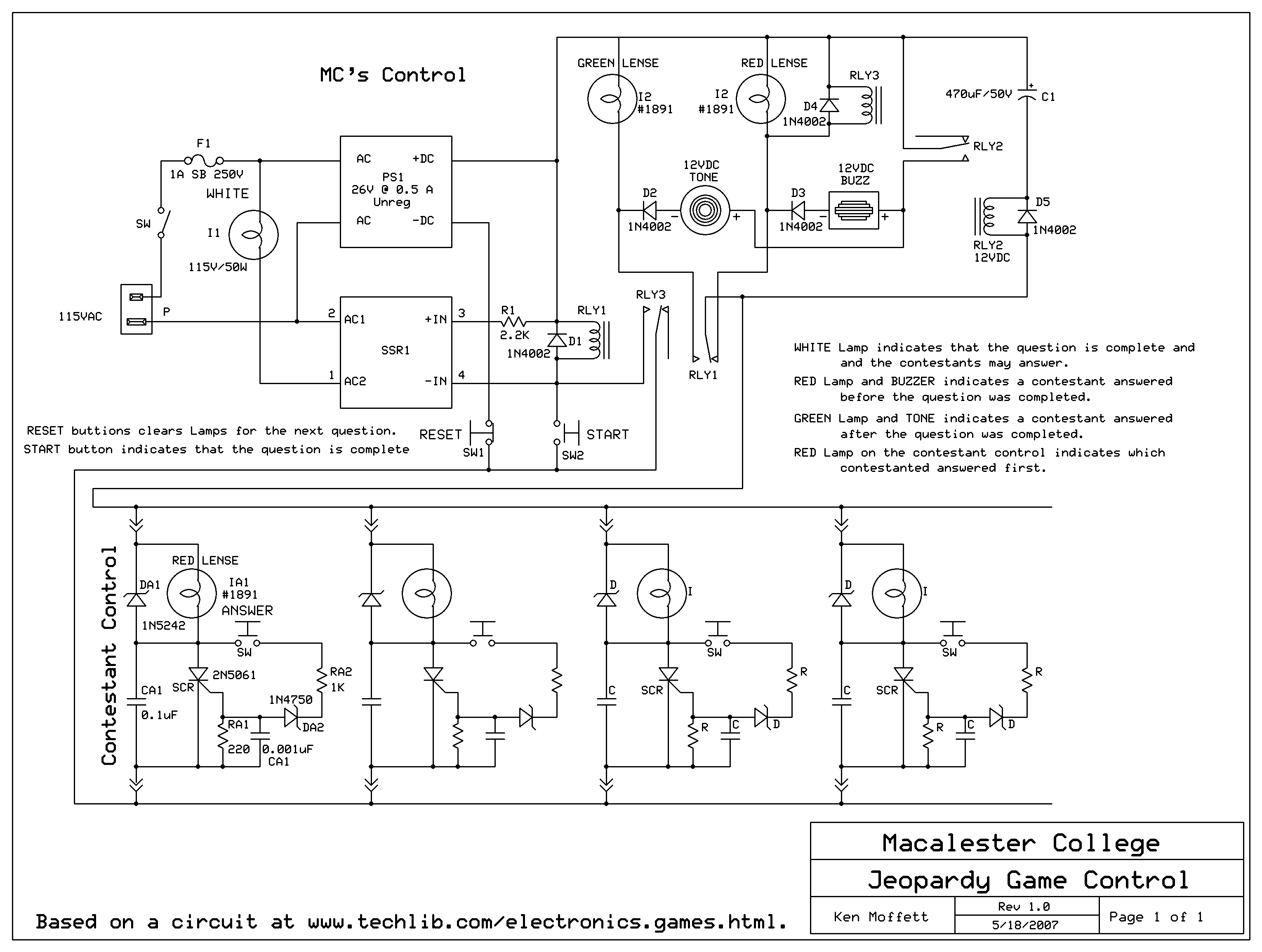

Can someone please help us...son has senior project for school. He is building a game-show type contraption that has four buzzers. When the first one clicks in, it is suppose to make his light come on and block the other three. We haven't been able to find much help and what we have gotten is controdictory. Help please!!!
Have you googled?:
jeopardy game show buzzer control circuit
Don't use quotes!
An ultra simple one: http://www.techlib.com/electronics/games.html
The first one should do exactly what you described.
The one further down the page is what I used as a basis for one I built many years ago, with 6 stations, for our Biology Department for per-final prep quizzes. Attached. Now it moves around campus, and periodically to another college. :)

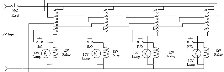

Here is one that uses 12V AC relays and indicator lamps
