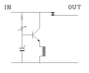

Hi themikestar,
play with the component values,
till you're happy with the delay period.
Best of luck with it, John :)

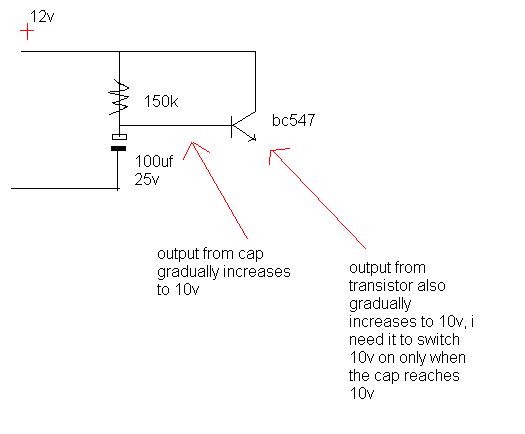

i can get the capacitor to gradually charge and output 10 volts, bu i cant get it to switch a voltage through the transistor, i get the same reading from the transistor that i get from the capacitor (gradually increases from 0 - 10 volts). What am i doing wrong ??

That sounds about right actually,
the relay should jump in at about 8 or 9 volts,
assuming its a 12 volt relay.
when i connect the relay to the transistor it draws so much power it drops the volts back down to 1v (and the relay wont close), so i guessing the transistor is doing nothing and that the realy is drawing power direct from the cap and the cap cant keep up. I know i have done something wrong with the transistor, what is it ??
the diagram of what i have at the moment is below
thanks
Hi themikestar,
from the values you've put there, you are aiming at quite an
interval, maybe six seconds or so ?
That transistor is capable of one tenth of an amp, maybe your
relay needs a little more ?
If you're happy that the Tr should operate that relay ok,
then you will have to reduce the resistor until the relay
operates,
then increase the cap to the interval you want.
(if the cap becomes larger than you would like, you could
'darlington-up' with another transistor, then the resistor
and cap would be different values, smaller cap, and higher
resistor.)
John :)
Hi themikestar,
If the circuit is as you have shown,
then you have not done anything 'wrong' with the transistor.
Its use as an emitter follower might just be new to you,
as a normal amplifier the collector would not be connected
directly to the supply.
It is possible that this is why you feel something is wrong,
but its ok.
John :)
i will try it again with a smaller relay. I'm am not really familiar with transistors, what is the purpose of the transistor in this circuit, my understanding is that when the base voltage reaches the same as the collector voltage then power passes from the collector to the emitter, is that correct ??
thanks for your help john1
i have found that it runs an led (with a 470 res) perfectly and if i tap the wire from the relay coil onto the emitter leg the relay cuts in perfectly, but if i start the circuit with the relay connected i get nothing. i dont know what to try next, i cant find a smaller relay until tommorow

yes i have a working multimeter. the circuit works fine when i remove the resistor and charge the cap directly, bu there is no time delay. i tried with a smal relay even a 5v one and it still didn't help.
came across this on the net, i tried this new circuit and it works perfectly, it also explains why the other circuit didn't work
