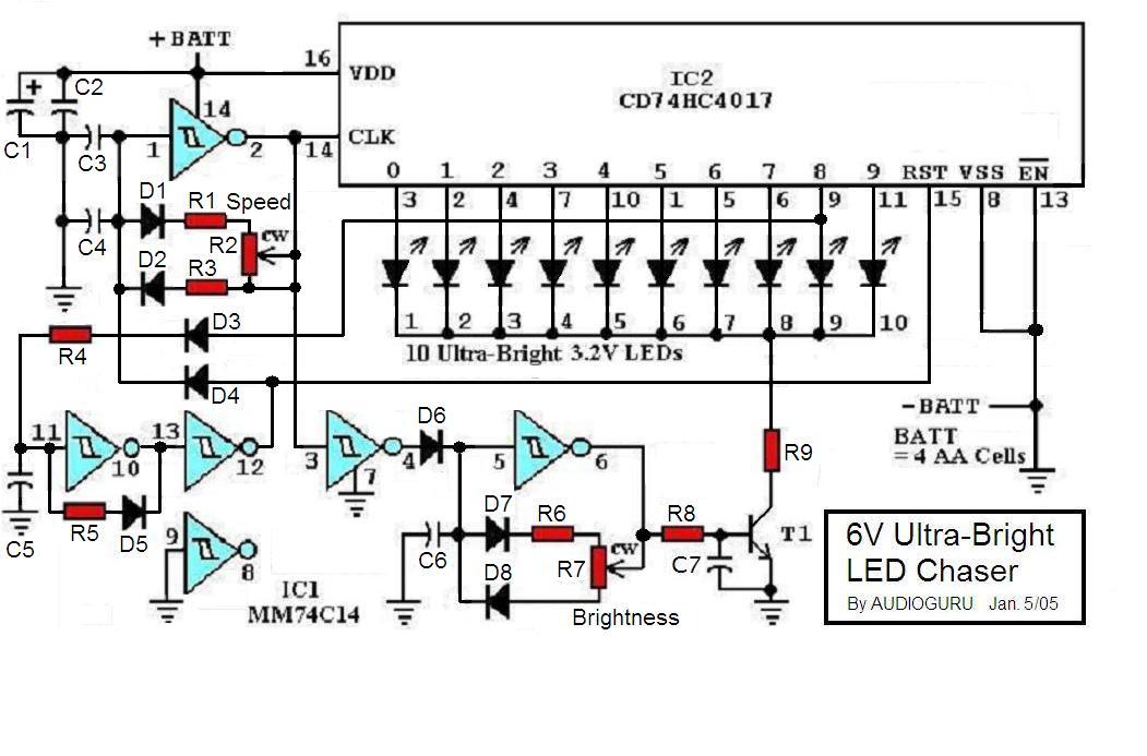

In my Ultra-Bright Chaser projects, the LEDs were still very dim when the PWM brightness control was turned all the way down. The pulse was so narrow that I couldn't see it on my 'scope. Adding C7 at the base of the driver transistor fixed it.
Sorry for the JPG fuzzyness. I was still a pc noobie.
