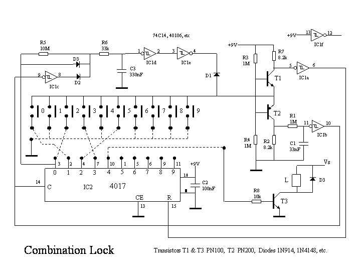

Here is a keyset lock that I designed and posted a year or 3 ago. From memory, I think someone in India built and tested it and was pleased with the result.
Virtually any small signal transistors would be suitable.
The combination shown (as an example) is 3247. More or less digits can use used if required. The only restriction is that the same digit can't be used twice (or more).
