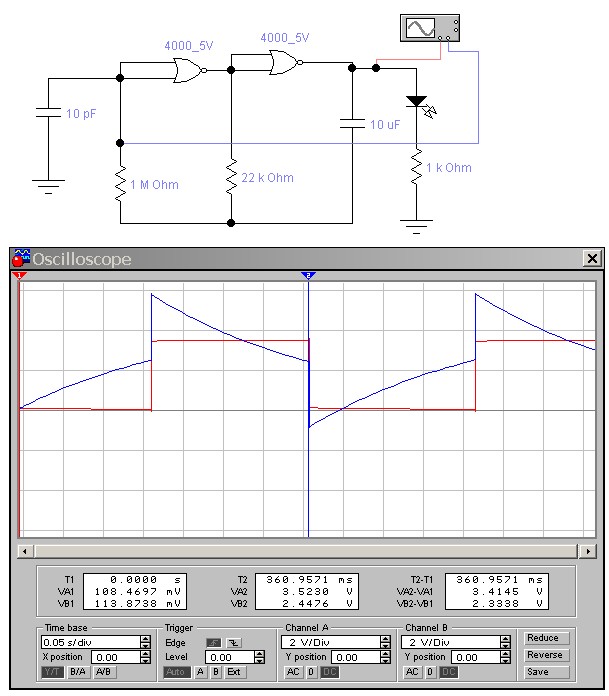

The circuit I've built is just a simple oscillator using a 4001 NOR gate. It seems that Multisim isn't calculating the RC time constant correctly. The frequency Multisim is showing on the Oscilloscope is way faster than it should be when I built it on the breadboard with my son. I've been pulling my hair out all day trying to figure out what's going on.
Here's a screenshot of the Oscilloscope and the circuit:
https://i613.photobucket.com/albums/tt214/stevenbeckman/NANDOscillator.png
If someone could throw me some advice, I'd really appreciate it. If I do the math for C1 to charge through R3 I get 220 milliseconds which is right for what I'm seeing on the breadboard.. the scope in Multisim is showing a tim/div of 200nS which is way faster than it should be.

Multisim is showing a period of about 120nS which is of course way way faster than what I observed when my son and I put the circuit together on the breadboard.
I just wish there was a way to fix Multisim so the program output was correct. Very frustrating. I'm guessing there is a way to run the simulation correctly, but I certainly can't figure out how to do it so far.

The values are 10mF for the Cap and 22k for the resistor. I attached a link to a screenshot of the schematic so you can see the values and the reading on the vitual oscilloscope on the OP.

Since it's hard to see, the scope tim/div is at 200nS not milliseconds.

I finally was able to view your circuit and simulate it with my old copy of Electronic Workbench (now part of Multisim) and found the apparent problem. You need to add a small capacitance from the input of the first inverter to ground to simulate the normal input capacitance (10pF will work, see below). Somehow without that to suppress the high frequencies, the CMOS model goes into some strange high frequency mode where the input and output of the NAND gate are in-phase rather than inverted as they should be. This causes the high frequency oscillations.
