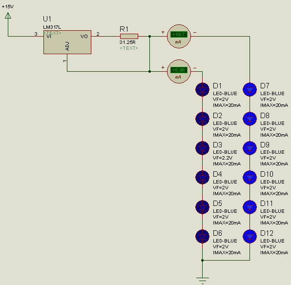

Hi everyone, I am currently working on an LED grow light which consists of 20 1W blue LEDs, 20 1W red LEDs, and a 10W soft white LED (shown in yellow on my diagram).
I have mocked up what I think the circuit will roughly look like, but need a bit of help with the details of it...

Hi Col,
welcome to the forum.
One string of four LEDs requires 300mA, which are 10 strings total, requiring 12V at 3A, not counted the white LED at approximately 1A.
You must use a current limiting resistor in each string because of different LED forward voltage and currents resulting using just one current limiting resistor for five strings (blue and red each).
Dimming the LEDs with a single pot is not possible for the reasons already mentioned above. Carbon film pots cannot be used to dim those relatively high current LEDS, even if using a separate pot in each string. At a current of 300mA and 1V of voltage it has to drop the power dissipation is 0.3W - which they can't handle. (0.25W max)
I suggest to use constant current sources as offered by many LED shops and select one suiting your needs best.

Hi Col,
I've simulated a circuit with two strings of LEDs (5 in series). If only one LED has a different forward voltage (D3=VF2.2V) from the others the forward current drops considerably for this chain, hence dimming the entire string. (see attached simulation and the values next to the LEDs and the connected am-meter)
So the L200 will be wasted, since each string requires its own current regulator, which could be done using LM317T for 25Cents each. (The L200 is about US$2)
Using discrete voltage regulators wired as constant current regulator this would mean to use 11 regulators total (5 for red, 5 for blue and 1 for white). The next question would arise how to dim 5 strings using one knob.
I will check the possibilities to use an integrated LED control circuit, which I know are available even with PWM-control to dim the LEDs.
