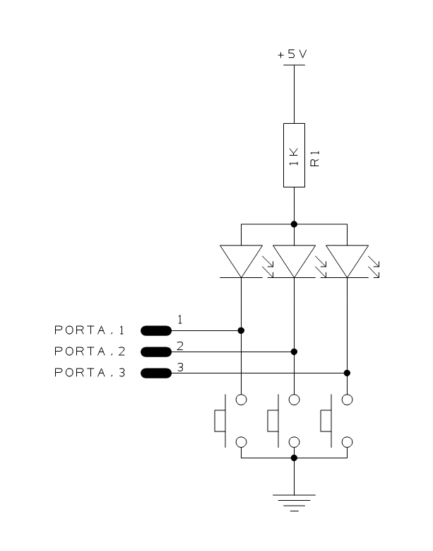

I am working on a PIC based board and having logic issues reading switches.
uController: PIC16F628A
Language:Assembly
I am utilizing all the inputs/outputs of this chip.
PortA: 1, 2, 3 are setup as inputs
SWS: is a 3 position SW, displayed here as 3 separate switches. Only one switch can be ON at one time, Common anode.
Function: If Sw is in position 1, LED1 is turned on, and PortA,1 is set high. When PIC reads the logic of all 3 SW's, sees this as logic "1" on PortA,1 and does something. Same true for other SW positions..... PortA,2 and 3...
When SW is closed, PIC sees logic 1. No problem. When SW is open, PIC still sees LED Diode voltage. (not logic "0")
This is enough voltage to keep port status high and fail logic zero test. Any suggestions to overcome this issue?
Thanks in advance for your suggestions.

I believe that Port A is all Schmitt Trigger. The microchip switching levels are 0.2 and 0.8 x VDD .
Have you considered putting a relatively high value resistor (10 k to 50 k) in parallel with the diode or diode/resistor. That will ensure a positive pull-down without the diode drop without greatly affecting the on current available..

Hi John
I did consider that. If I have to, then will do. I am keeping the PCB real estate tight. But can manage 3 resistors in there somewhere.
I was hoping there is an internal feature of uC that when a pin is set as an input an internal pull-down resistor can be activated. Not sure if that is the case!
I also thought about setting the pins to zero (BCF PORTA,1 for example) before reading status of the SW. But it seems that it does not make any difference.

How about low side switching? Connect the LED's from Vcc to the switch and the switch to ground. You'd have to invert the logic in the PIC.
If you use port B and invert the logic then you can use the internal weak pullups of the chip. Some of the newer pin compatible pics have WPUs on port A too.
Wow thank you for the responses. I try to answer them one by one. I could do low side switching (not a problem). But does PORTA have pull-up resistors internally? If not, I would have the same problem. How about using the comparator function to force the pin low?

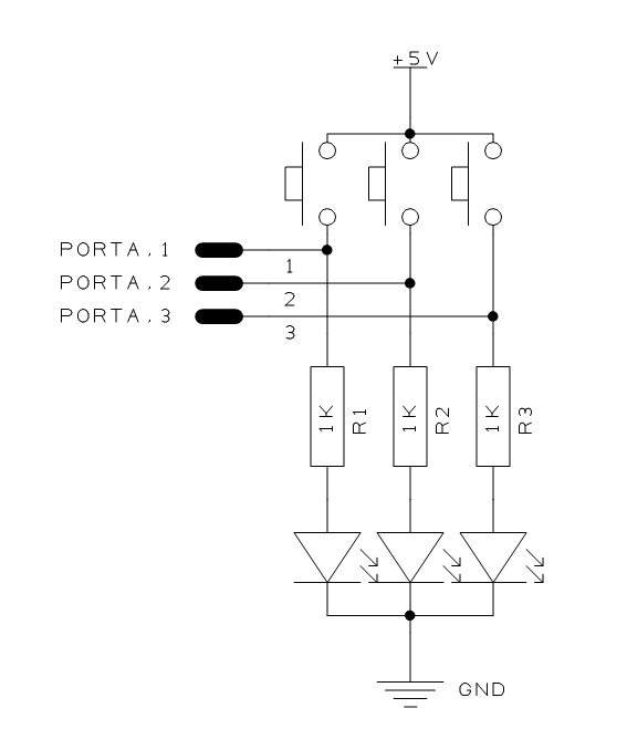

I think this is what you fine gentlemen are suggesting. We call this version Common Anode. Vs. Previous version being common cathode. Would this work?

That will work but not without pullups. Either the internal ones or something like 50k resistors across the LEDs.
So you don't think LED and resistor will provide logic "1" with all switches open?
Edit: I m thinking when pic pin is used as an input, it sees a high impedance (100k-1M). So the voltage divider (diode plus resistor being Rx) and internal high impedance Ry. PIC pin would sense 5 x Ry/(Rx+Ry) =~ 5 x (100k/105k)= 4.7 volts?!
Rom. Your "common anode" diagram is correct.
Gentlemen, I just tested some code on a little 8-pin 12F1822 and it's working fine without internal or external pull-ups. I should probably check to see what type of inputs on the 12F1822.
I'm assuming (dangerous, I know) that the leakage on the pin is able to cause a forward voltage drop on the LED that is higher than 1V and so the pin doesn't reach the 4V required for a schmitt input.
Ah... I think you're right. I measure 3.8v on RA0 with the switch and LED off. That's plenty for the high level on the 12F1822 'TTL' input but not quite high enough for a Schmidt Trigger input to register as a high level.
Is there a chance my multi-meter is introducing additional current and an additional voltage drop at the RA0 input? Perhaps I should try this code on a device with ST inputs like Rom's 16F628A?

RA2 is ST on that chip. Since you are already set-up, maybe just switch pins to see if that is the problem.
John
Cool... I just hooked up to RA2 and it's working. Here's the 12F1822 test code;

;  main loop                                                      ~
;  *  Lighted Push Button Switches (emulated toggle switches)
;  *  swnew  ____---____-----___   sample active lo switches
;  *  swold  _____---____-----__   switch state latch
;  *  swnew  ____-__-___-____-__   changes, press or release
;  *  swnew  ____-______-_______   filter out 'release' bits
;  *  flags  _____-------_______   toggle flag bits for main
;  *  trisa  -----_______-------   toggle tris bits for LEDs
;  while(1)
;  { delay_ms(25);              // sample at 25-ms intervals
;    trisa |= 0b00000111;       // set RA2-RA0 pins to input
;    swnew = ~porta;            // sample active lo switches
;    swnew &= 0b00000111;       // only RA2-RA0 switch pins
;    swnew ^= swold;            // changes, press or release
;    swold ^= swnew;            // update switch state latch
;    swnew &= swold;            // filter out 'release' bits
;    flags ^= swnew;            // toggle flag bits for main
;    porta &= 0b11111000;       // set output latches to '0'
;    trisa ^= flags;            // light only active sw LEDs
;    if(swnew)                  // on any "new press"
;      beep();                  // task a "new press" beep
;    if(swnew.0)                // if sw RA0 'new press'
;    if(swnew.1)                // if sw RA1 'new press'
;    if(swnew.2)                // if sw RA2 'new press'
loop
        DelayCy(25*msecs)       ; sample at 25 msec intervals     |00
;  K8LH parallel switch state logic and "new press" filter
;   wreg  ____---____-----_____   inverted active lo sample
;  swold  _____---____-----____   switch state latch
;   wreg  ____-__-___-____-____   changes, press or release
;   wreg  ____-______-_________   filter out 'release' bits
;  flags  _____-------_________   toggle flag bits for main
        banksel TRISA           ; bank 1                          |01
        movlw   b'00000111'     ;                                 |01
        iorwf   TRISA,F         ; set RA2..RA0 pins to inputs     |01
        banksel PORTA           ; bank 0                          |00
        comf    PORTA,W         ; sample active lo switches       |00
        xorwf   swold,W         ; changes, press or release       |00
        xorwf   swold,F         ; update switch state latch       |00
        andwf   swold,W         ; filter out 'release' bits       |00
        movwf   swnew           ; save 'new press' bits           |00
        skpz                    ; new switch? no, skip, else      |00
        movwf   flags           ; update 'on' flags (1 of n)      |00
;       xorwf   flags,F         ; toggle 'on' flags (n of n)      |00
;  light LEDs for switches with an 'on' flag
        movlw   b'11111000'     ; mask off RA2-RA0 bits           |00
        andwf   PORTA,F         ; set output latches to '0'       |00
        movf    flags,W         ; pickup sw2..sw0 states          |00
        xorwf   TRISA,F         ; trisa ^= flags (light LEDs)     |01
;  check for "new" switch position change
        btfsc   swnew,0         ; RA0 on? no, skip, else          |00
        call    off_mode        ;                                 |00
        btfsc   swnew,1         ; RA1 on? no, skip, else          |00
        call    man_mode        ;                                 |00
        btfsc   swnew,2         ; RA2 on? no, skip, else          |00
        call    auto_mode       ;                                 |00
        goto    loop            ;                                 |00
off_mode
man_mode
auto_mode
        return                  ;                                 |00

Thanks all for your input.
Pommie I am not sure if Vd exceeds 1V on SW-open. I do see your concern though.
If it is more than 1V then I have another problem: The LED would be partially lit (dim but never-the-less ON)
The Red LED does not take much volts and amps to lite up!
I might just bench the common anode with 16F628A and check how the chip does.
Mike: Thank you for the code. Given my switch is not a push switch but rather slide-lock to one position (switch status change is long), could it simplify the code a bit since we are not worried about debounce and time delay sampling switches?
