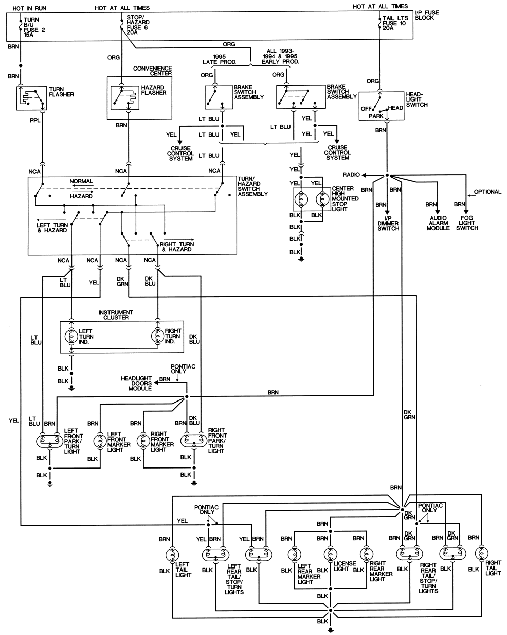

Ok the simplest thing if you have an automotive shop near by, you should get a thermalblinker relay. It's basically a relay with a heating element and sensor. Most cars use this and all you need to do is add the 12v lights in with the circuit and a couple switches and your set here are the schematics for my firebird that should give you an Idea. It has the entire schematic for wiring up the lights for everything but you just want to look at the Flasher Part. Thats one way to go if you want. But there are very many ways to do what you want.

Thanks, magickaldan. That's a good, complete wiring diagram; I think my Jeep is wired exactly the same way. I know it uses a GM steering column and turn signal switch.

Hope this clarifies what I'm trying to accomplish. Thanks again, magickaldan, for the diagram. That's going to help me determine tie-in points. - Chris
for a steady burn, while the blinker is blinking... just tap the blinker circuit before it gets to the thermal relay... basicly the relay has 2 poles (at their simplest at least) ... power supply and output... power supply is always on, and output pulses on and off as a small heating element causes a circuit to make and break.
so if you tap your cornering lamp into the always on side of the blinker relay, your cornering lamp will be solid on as long as the blinker relay is receiving power.

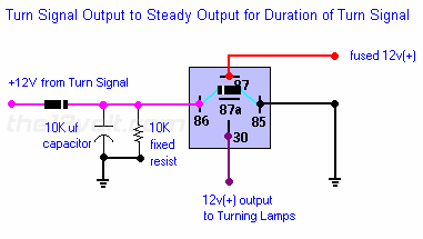

This circuit need for each side. The input coming from blinking lamp, the additional lamp continous burn, when input go low, after few seconds the lamp started fading,like indoor light in new cars. Depending from lamp power, need heatsink, or replace the lamp with relay.(no fading, no heat)
Increase the capacitance for a longer duration.BTW this is tested and works correctly.
Thanks a ton to you all! A question for Eclipsed - below the words, "+12V from turn signal", at the far left of the diagram, is that the 1A diode that Gerty says will work? With the white stripe on the right end, I would think it is, but I don't want to assume. Thanks again for the help, guys. - Chris
I used to work in a specialty vehicle repair facility where we routinely used 6A diodes to keep front and rear air conditioning controls from back-feeding each other. Would that "big" a diode be better in this application?
Looking at Eclipsed drawing you can see that the load will be about 200ma or less, depending on relay.. The diode isn't being used to supply power to the cornering lamp, just relay and resistor..
