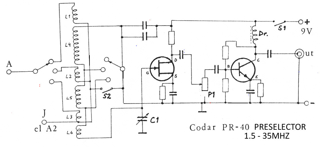

Hi, I want to build a codar PR40 hf preselector using the attached schematic. But I am unsure of the type of band
switch required for the inductor. I am sure that an old pr40 I had years ago had a DP 12 way band switch but I
can't really remember.
So If some kind person could look at the attached schematic , maybe they could work out what type of band switch
I need to purchase.
Thanks.
Simply a 2 pole 3 way rotary switch - although it may be easier to find a 2 pole four way one (and ignore one way (or on some you can block positions).
EDIT:
Just did a quick google - here's a suitable switch, ignore two of the poles:
