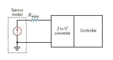

Here is a brief of what I must do. Could anyone help me with a circuit that will work and the components that I will need please!
Design Project. Due date: 8 November 2013
Background
In factory instrumentation, process parameters such as pressure and flowrate are measured,converted to electrical signals, and sent some distance to an electronic controller. The controllerthen decides what actions should be taken. One of the main concerns in these systemsis the physical distance between the sensor and the controller. An industry standardformat for encoding the measurement value is called the 4–20 mA standard, where theparameter range is linearly distributed from 4 to 20 mA. For example, a 100 psi pressuresensor would output 4 mA if the pressure were 0 psi, 20 mA at 100 psi, and 12 mA at 50 psi. But most instrumentation is based on voltages between 0 and 5 V, not on currents.
Problem
The circuit in Figure1is a very accurate model of our situation. The wiring from the sensor unit to the controller has some resistance Rwire. If the sensor output were a voltage proportional to pressure, the voltage drop in the line would cause measurement error even if the sensor output were an ideal source of voltage. But, since the data are contained in the current value Rwire, does not affect the accuracy at the controller as long as the sensor acts as an ideal current source.
Figure 1. Sensor to controller connection
Design a current-to-voltage converter that will output 0 V at 4 mA and 5 V at 20 mA.
Write a report describing your design.
Tip – Use Opamps

This is the basic diagram that came with the assignment
Basically what is needed is a 249R precision resistor connected into the 4-20mA current Loop.
One side on the resistor is connected to 0V/Common, the other end then will have, due to a 4mA thru 20mA flowing thru the 249R, a voltage of~ +1V thru ~+5V.
This a is a 1V to 5V Span for a 4mA thru 20mA current in the loop.
Your design will have to cancel/remove the +1V, so that the Span becomes 0V thru +4V,, also it will also have to amplify this to 0V thru +5V.
I would consider a dual OPA powered by say 9Volts, one half of the OPA would be used for the generation of a stable +1V offset voltage and the second a low gain amplifier.
From these hints/clues design your circuit and post it here and we will check it out.
Is important that you attempt the design and show us what you have done yourself.
E
Why 249 Ohm?
250 Ohm 0.1% (or 0.01% if you can afford) resistors are commonly used to give an accurate 4-20mA to 1-5volt conversion, and would be found in any instrument workshop.
249 Ohm? I doubt it.
I bought and used 249R 0.1% precision resistors for many years in just this type of application.
As the OP has to cancel the Voffset and also amplify the signal across the resistor, the value is not critical, so I suggested a resistor which will get the job done.

However, from a practical testing point of view, a 250 Ohm resistor makes life much easier when trying to measure the input current.
1v = 4mA
2v = 8mA
5v = 20mA
Whereas for a 249 Ohm resistor
0.996v = 4mA
1.992v = 8mA
4.980v = 20mA
To my simple mind, the 250 Ohm resistors make life easier.

In practice when using OPA's any value from 100R thru 1K will do, in hindsight I should have stated this to the OP.
Eric
NOTE: Ensure that with a higher value load resistor that there is a sufficient overhead voltage for the remote driver.
