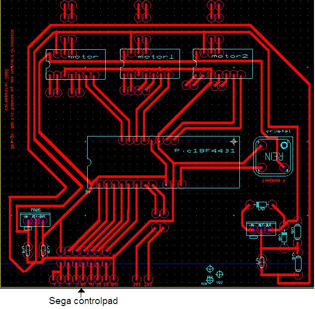

Hi, I need a little problem with my c-code. I'm using a PIC18F4431 to control 3 stepper motors(bi-polar). And using a Sega-pad to send 1 or 0 to the microcontroller.
I've connected only one 1 stepper motor atm, but having some difficulties with the program. I only get a response from one of the buttons on the pad.
Need help with direction etc. Does anyone know how to make i work??
Here is what I've done so far:

// Pin_D7 is connected to Direction input on Stepper motor driver (PBD3517)
// Pin_A0 and Pin_A1 are inputs from the Sega cotrol-pad
