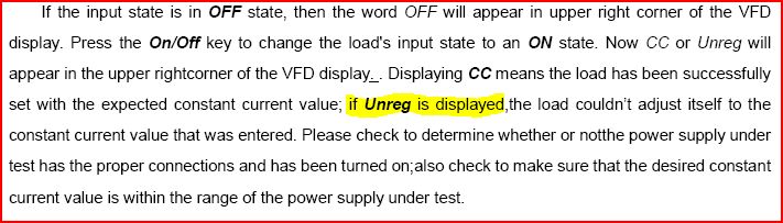

Here's the problem, I set the Constant current value via I-Set -> type value -> Enter. Then I press the on/off button, and the "OFF" changes to "Unreg", which the manual says to check the supply, and the connections. I have tried two supplies, anywhere from 0-50V, and current settings between 0.25A and 5A on the load, I still always get "Unreg".
I simply have my power supply wired to the dc load, + to +, - to -. I believe this to be correct, as the M9710 reads the input voltage. I just never get any current draw, even in "short" mode. Also, my ohmmeter reads several dozen kOhms of resistance, in all modes.

This is the first thing that caught my eye (page 11):
cowboybob, thanks for taking the time to look. I saw that as well. I have the power supply on, and it's good for up to 30A, and the load is reading the voltage, so I think I've checked all those things.
What I didn't check was the input voltage switch on the back. It was set to 220, and when i turned it to 110, everything works fine. Case closed.
