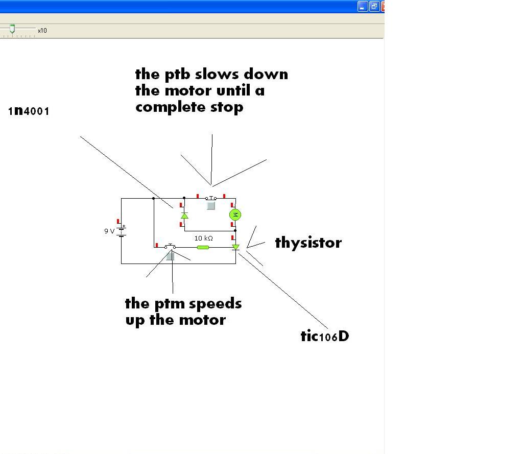

well i have something like this not exactly what your'e looking for but its good
wait il post a scymatic(sp?)
hmm, i don't really know about electro scheme yet, but it seems it is not actually what i needed.
But thank you maor.

Does it have to be remote control?
If not, it would be easy to connect a SPDT switch to the batteries.
the center terminal would be one motor lead. The other 2 would have the one battery or the 2 battery connection, with the other lead connected to center.
If it has to be remote control, good luck! that would be difficult for a beginner (as I have yet to learn that)
