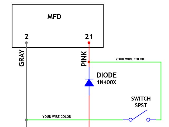

Now on to my project. I have a 2006 Toyota Prius. It has a review view camera that is activated when it goes in reverse. This camera can be activated anytime by tapping into the reverse signal. What I would like to do is add a front camera, tap into this signal and switch between front and rear cameras at anytime. I have a schematic of the reverse signal mod and the switch I have for the car. They are below.

This is some snippets from another site about the mod. http://www.evnut.com/prius_mfd_video.htm
The goal for the switch is to selectively jumper the gray wire to the pink wire, and the diode is to keep the reverse lights from turning on. Nothing gets pulled to ground, we're just passing the + signal of the gray wire over to the pink wire to activate the camera and screen. This will activate the rear camera anytime.
![ATCMS.jpg ATCMS.jpg](https://www.electro-tech-online.com/data/attachments/9/9156-1f7fdc6fc2524ad7ab96705232231674.jpg)

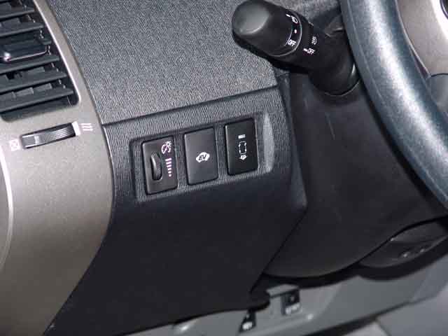

The button I have is the one pictured to the far right. This is an SPST momentary switch.
![customeuroipa.jpg customeuroipa.jpg](https://www.electro-tech-online.com/data/attachments/9/9155-2f18721a00969f181f702dd8c8c24b42.jpg)

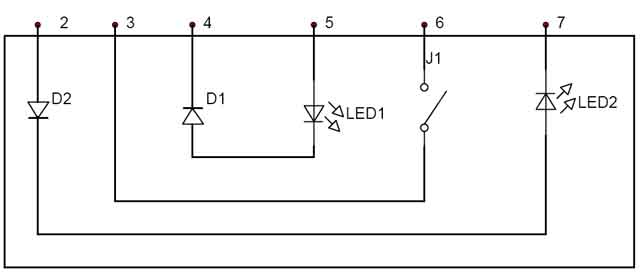

The pins for the switch are...
2-7 Indicator LED
3-6 SPST switch
4-5 LED Rheostat controlled. I have this one covered. There is no need to design for this.
![ipaschematic.jpg ipaschematic.jpg](https://www.electro-tech-online.com/data/attachments/9/9157-eb994812c6cd0ba56c9382dc227fb139.jpg)
