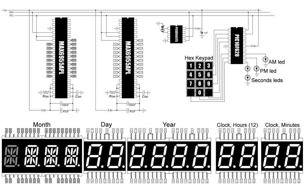

I've come up with a circuit diagram to help myself see how this thing will work. It does not show the keypad I want to use to interface with the PIC controller, I wanted to add that after I understood the PIC's pinouts. If anyone sees anything grossly wrong or out of place, please let me know. Thanks!
*update*
I figgured since it has programmable I/Os, I could pick which pins to use for the I2C bus. Don't know if I'm correct about that, but it lets me finish out the diagram with all the components I wish to use and how I think they're supposed to be connected. Again, if anyone sees anything wrong/missing/out of place, please let me know. Thanks!
