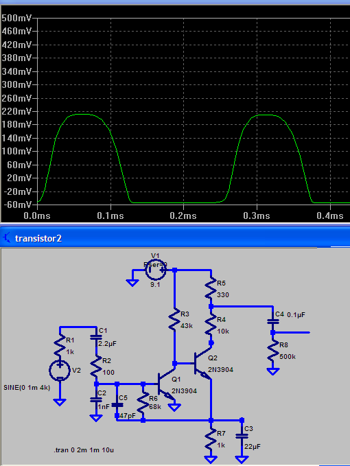

I sim'd the stupid circuit and it sure makes fuzz. I assumed a pickup impedance of 1k and fed a sine-wave signal of only 2mV into the thing. With a larger input signal then it will make more (!) distortion.
My sim doesn't have an MPSA18 transistor so I used a 2N3904 that doesn't make any difference.

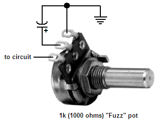

You didn't say if the pins on the transistors are wired correctly like my pic.
Check its "fuzz" pot's wiring, it must be correct for it to work:
Yes everything is connected correctly.
