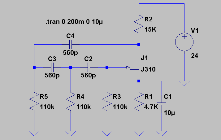

Hi Chris,
A phase shift oscillator with a fet is a bit more tricky
because it's difficult to get the required gain at a
low supply voltage.
on1aag.

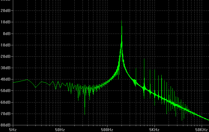

Thanks! but what is this J310, I tried with 2N4393 but didn't work. I think I should avoid to make PS osci with JFET, even over the internet there are not any PS osci. with JFET I tried a lot, they all just explain that simple phase shift network and gain theory but no practical example.But I still would like to make it just for once, please tel me what type of JFET that is. Thanks again!
Hi Chris,
The J310 is a fet with a high gfs, the J310 is the plastic TO-92
version, the U310 is the metal TO-72 version.
The circuit should work with most fets with a high gfs, like
J308, J309, J310, half of J430 and J431 (these are dual fets),
and of course also all the U versions.
I got curious and built the damn thing, it didn't work, but
I got it working !
I increased the supply voltage to 30 volt and lowered the
source resistor to 3k3. It comes down to a drain current of
about 1 mA and a drain to source voltage of about 12 volt.
I tested ten J310's from Motorola and the output voltage of
the oscillator was between 8 Vpp and 16 Vpp.
I also tried a couple old Siliconix J310's and they worked
without changing the original schematic.
I also tested a couple of old Siliconix J300's and they looked
very similar to the Motorola J310's.
I even tested a couple of 2N4393's in a plastic TO-92 housing
and got them working too.
Give it another try and let us know how many went through the
ceiling. :D
on1aag.
Hi there!
I don't have that much big DC supply so I tried it in simulator (circuit maker) and it works, in fact it also works with 9V source but the amplitude is only few mV, but even with 30V it takes time to start oscillation. Thanks for help!
BTW: Won't it be temperature sensitive ? Having such a low drain current will make it very unstable oscillator, won't it ???
How did you find values of Rd and Rs, imean where did you start from ?
I was trying to make gain = 1 but that was only peak to peak that's why it was not working so I got that the method is the same with BJT but still don't get why the Vgs ~ 1V necessary, if decreased from that then the output goes to uV level ????
