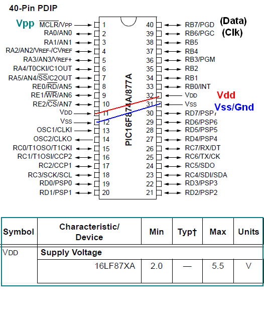

I'm trying to program a PIC16F877A. I have one of those, and a Junebug. I'm trying to figure out howto hook the sucker up to the Junebug, but I have to say I have no idea. The instructions that came with the Junebug are just as cryptic.
First off, the PIC16F877A is indeed a 3.3v uC right?

the device is 5V working, please see the relevant data sheet.
you can program it by connecting the Vpp, Vdd, Gnd, Data and Clock pins as indicated in the PICKIT2 user guide.

you may place the 16F877A on the bread board, connect the concerned few(5) wires to the relevant pins by short lengths of wires of the extension cable from the programming connector

I hooked up the PIC16 as in your diagram which was fairly straight forward
VPP-VPP
5V->VDD (both)
GND->VSS (both)
PGD->data
PGC->clock
I opened up PIcKit2, selected a PIC16F877A as my device, and it reads it. I clicked Verify, and it did verify, but told me there was a VDD voltage level error. "Check target and retry operation." But then when I click verify again, it does it, successfully, but stills gives me that error message/ What does that mean?

Tr to post the schematic of your hardware, if you wanted to try programming the device right from where it is in your board. In case you have used the ICSP data and ICSP clock pins for any purpose in your board, you may have to isolate those loads for a while.
Also the Mclr pin should have a 10K resistor to Vdd and not a direct connection.
Finally Any high value electrolytic capacitor on the VDD pins like 100uF etc would delay development of Vdd unless they are charged, this would raise the error Vdd voltage level alarm.
You may use PIKIT2 ver2.61 or so directly instead of working from MPAB
the hex file location can be given to this software for loading it.
Please note that the VDD derived from the Junebug may not always be able to take load of the target circuitry, depending on the complexity or load. As such you may externally power your board, and in PICKIT2 disable powering from internal.
At this stage please erase and have a check for blank chip before any other step.
let us see whether you can proceed ahead. All the best.
