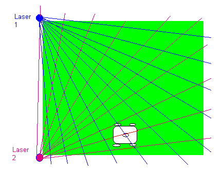

Global or Lawn Positioning System ?
If there is a clear line of sight accross the lawn then maybe two lasers could be used ? (see drawing)
Each laser is arranged to scan using a stepper motor, this allows a simple, known angle to be set and transmitted by the laser head - possibly modulated on the laser beam itself.
As there are two lasers at adjacent corners of the lawn it should be easy for the mower to calculate its position using basic trig.
If one laser is 'slaved' to the other - only starting to sweep and transmit after the 'master' has swept past it then there will be no problem for the mower deciphering which angle was transmitted by which laser.
Refer to sketch:- Imagine laser 2 (red) is the master, it sweeps anti-clockwise in 1 degree steps. Eventually it will reach an angle where laser 1 (blue) will see this and start its own (clockwise) sweep of the lawn. This should ensure that the mower will never see both lasers together.
If the lasers step in 1 degree increments then you can resolve a position to within 4 inches on a 20 foot square lawn; the mower must not move more than 6 inches without receiving another positional 'fix' via the lasers.
Dumb enough to work :?:

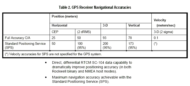

Differential GPS would be required to get the needed accuracy. There's a reference GPS sensor on a fixed stake and a similar sensor on the moving object and radio communication between them. The 30ft+ position error that comes from the satellites will be the same on both sensors so an accuracy of inches is possible. Sadly I don't think stock sensors can do this though, they don't even report lat-long to that degree of precision.
GPS Accuracy
I know that the Rockwell Jupiter is an old design but if this is the standard of these things ...

Differential GPS can achieve remarkable accuracy with high precision equipment (I believe an extremely accurate reference clock is essential) and a low distance between the reference station and the measuring station.
The reference station can be part of the DGPS corrections network, or your own equipment placed in a fixed location (which will likely be much closer).
