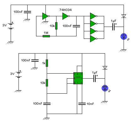

I have recently started adding lighting to my clocks with fiber optics and LEDs to light them. The backs of the clocks have limited space, so I am powering from 2 AAA batteries. (A 1" X 1" proto board will fit). Works OK on LEDs with smaller forward voltages (1.7-2.8) with 47Ω 1/2W resistor, but need to get higher voltages for the blue and white which are over 3.0V. Also, need help with getting more life out of batteries, lights getting dim after a few days, and out after 2 weeks. Would 1/4W reistor help? Tried an LDR, but they pull 15mA when in light and the LEDs pull 20mA, so using almost as much battery when LED is off. I am a beginner with electronics, please keep it simple. Appreciate any help.

Another option is to use a 74HC04 voltage doubler which requires no wound components, I'll post a schematic if you're interested.

I am interested in any options that would help. Could you supply a schematic of what you are talking about ?

The two transistor Joule Thief circuit I posted uses a pre-made coil and an off the shelf pulse transformer or common mode choke can be used rather than the wound coil on the one transistor Joule Thief.
Another option is to use a capacitive voltage doubler, see attached, which requires an oscillator such as the 7555 or a CMOS inverter. Two AA cells must be used because the ICs I suggested need at least 2V to work.

I agree, the only time I'd really recommend a voltage doubler is when you're already using a couple of logic gates, a microcontroller or want to flash an LED.
You also might be able to buy a charge pump IC which can power an LED from two AA cells just by adding a capacitor.
