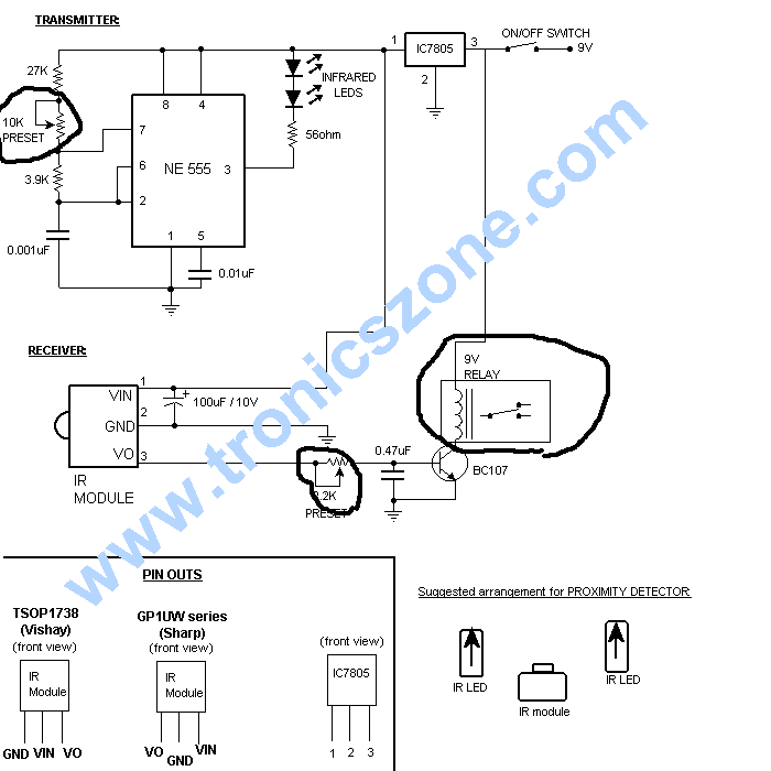

hey i found some circuit design regarding this(its infrared)
and there some things i dont understands.
specifically the parts said.
i encircled it for easy identifying
um 10k preset resistor is? 10k variable resistor?
and 9v relay what is the real product called?
kindly explain the diagram pls.
*i know the circuit works when beam gets block the relay will get deactivated
The 555 is generating 38KHz pulse to drive the IR Led's
The 10K trimer (potentiometar, variable resistor - not sure what the proper english term is) is used to fine tune the 555 oscillations to match the 38 or 40KHz IR Receiver will detect.
The IR Receiver detects only IR light modulated to 38 or 40KHz (depending on the IR Receiver used) and will sink the output pin (pin3 on the receiver on the schematic) to GND when the signal is detected.
Output pin (pin3) of the IR Receiver goes to base of the BC107 trough preset 2k2 trimer and when the output pin is high (no modulated signal detected" it will drive the BC107 that will power on the relay. The preset trimer is used to fine tune the base current to BC107.
The reason why this circuit is "good" is that IR Receiver will ignore all "unmodulated" light sources (like local light, sunlight etc) and will only respond to modulated light emitted from the IR leds being modulated by 555...
Looks like a decent circuit, not sure why they used a pot to drive the output transistor. A 1K resistor should work with a small relay.
