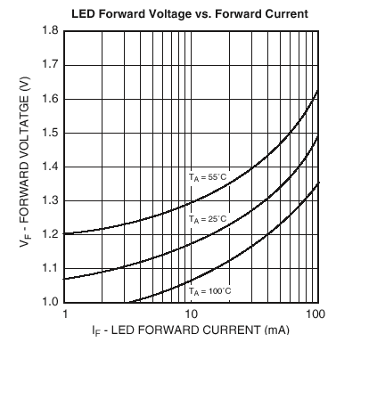

Ivancho, I wouldn't attempt to drive the MCT6 with a 1.5v battery. The LED would probably be destroyed. Driving it with a 1.5v logic signal would probably be OK, because the logic signal will probably have enough internal resistance (although the logic level may be degraded unacceptably). You seem to have interpreted the datasheet as a guarantee that, if you put 1.5v across the LED, the current will be 20ma. This is far from reality. The datasheet only says that if you force 20ma through the LED, the voltage will not exceed 1.5v.
Take a look at the Fairchild MCT6 datasheet, which has more information. I have pasted the typical voltage vs current curve below. Note that, at 25C and 1.5v, the current typically is over 100ma! This exceeds the maximum allowable current for the LED.
Keep in mind that the LED is a light emitting diode, and as such, a small change in forward voltage will result in a large change in forward current. Another way of looking at it is, LEDs should be thought of as current-controlled devices. They should never be driven from a voltage source.
The reason I said that this part might work can be seen from the curve below, keeping in mind that this is a curve of a typical device. At 20ma and 25C, the voltage is only about 1.2v, so there is voltage headroom for a current limiting resistor. However, you might buy a device which has 1.5v drop at 20ma, so the same resistor would give you much less current, and therefore much less light output.

So - If I understand this correctly, I need to attach the diode interface to the signal wire/ground and then the circuit which I will be grounding out (with only about 1ma current through that circuit) to the 'switched' interface.
My main concern is how much current the diode will draw from the phone/signal wire - I have no specs on how much this will supply but I expect that it will be very low..
A transistor BC 547 can do the job. simply connect your relay in series between the Vcc ( atleast 6 V ) and collector of BC547. Apply the 1.5 V control signal directly to the base of the transistor ( or through a current limiting resistor if necessary). Practically to use a transistor as a switch it is a good practice to maintain Ib = Ic/10 to keep the transistor in hard saturation. connect the emitter terminal to GND. 6V is necessary as 5V is required for the relay and 0.2V is the drop across the transister during saturation. This transistor can easily withstand 150mA of current flowing through it during saturation.
Ron H: You are right..... oops sorry about that. A 15 ohm resitor will solve that. 1.2V at 20mA will be enough to light the LED and bias the phototransistor.
