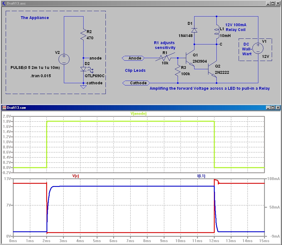

Hi. I am trying to figure out how to get a relay or if necessary a series of relays to trigger from a LED that has a voltage of 2V and power a household 120V AC. The plan is to get a horn or alarm to trigger when the LED lights. The LED is soldered onto the circuit board so the new circuit would have to be connected in parallel with it.

There is likely a current limiting resistor in series with the LED. If you simply took the output from the other end of the current limiting resistor, you might be able to drive a small DC relay directly. The contact rating would have switch the AC to your final load.

Well unfortunately the goal of the project is to clip onto the LED so that the new circuit can be removed easily allowing us to rma the unit in case of problems not caused by us.
Finding the switch might still be a viable solution if I can manage to trace the traces and still clip onto the switch. But if we can keep it simple to just clipping onto the LED that would be good.

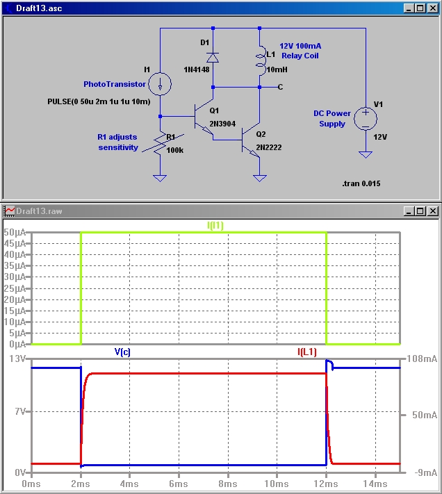

How about just coupling a photo-transistor to the LED optically?

Here is a typical phototransistor that has good sensitivity to Red light.
It costs about $1 in single qty.
It puts out about ~0.05mA with low illumination. If you had a relay with a 100mA DC coil, it would take a current gain of 50mA/0.2mA = 1000 to turn on the relay, so two NPN darlington-connected transistors would do it. The Pot adjusts the sensitivity.

What would be the benifits of using the phototransistor instead of just clipping onto the LED?
No clips. Non invasive. You dont even have to open the appliance.

The clip version:

Yep. It should have a full-wave rectifier in it, as well as a filter capacitor. If you can find one that doesn't have an internal capacitor, you can put one in the circuit. It should say something like "12VDC - 250mA" on On the Wall-Wart. If you want to use a relay with a different coil voltage, the Wall-Wart voltage nominally should match the relay coil voltage.

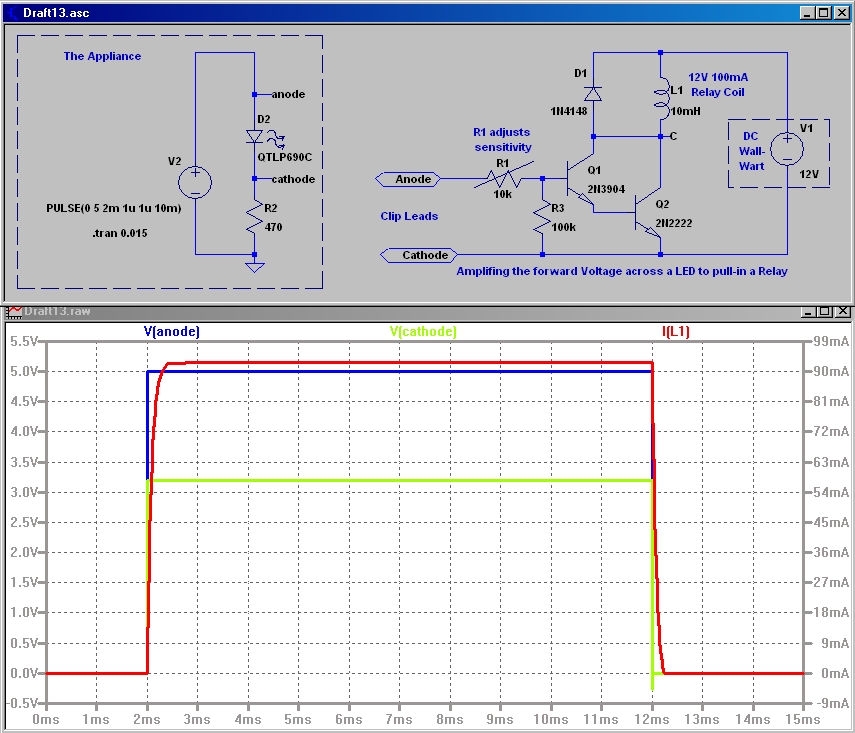

But, I've always wondered about ground plane. Your diagram has 2 separate grounds.
Is there a difference in the 2 grounds Appliance vs Wall wart or Are they just both at 0vdc and not to worry ?
Actually, I was trying to show that the relay circuit is not grounded until the bottom clip lead is attached to the appliance. Suppose that for some reason, the cathode of the LED was not connected to "ground", but say the series resistor and the LED were reversed. By having the relay circuit "float", it would still work... Note the current through the relay coil, which is all that matters...
