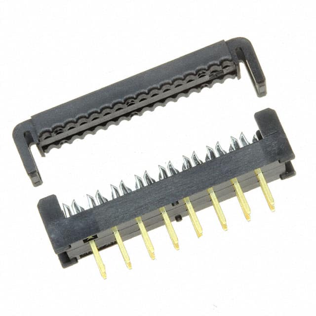

I couldn't figure out how to disconnect this connector and there's another like with more pins than this one As you can see I pried the nylon up and that left the pins exposed still hanging on Prying under the pins didn't seem to have any effect Also I need to identify whatever missing part/bracket held on the front panel jacks I found it laying loose inside
I don't think that is a removable connector.
Some gear uses pre-assembled wire harnesses that have things like that which look similar to plugs or sockets, but just hold a set of pins in the correct arrangement for soldering to a circuit board.
A bit like this example, for ribbon cable:
Sometimes the fixed part is just at one end of a wired link and there is a removable connector at the other end, but not always.

It's not a plug and socket, just a soldered in connection, often this is used at one end and the other 'might' have a plug and socket, but sometimes both are soldered.
Basically it allows the use of component insertion machines, and flow soldering - and makes a much more reliable connection than just soldering the ribbon cable through the board (as it gives support to stop the wire breaking off).
From a service point of view it's a real pain in the bum though, even if one end is pluggable, it's often hard to tell which it is.
