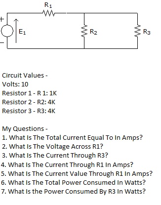

I'm having a really tough time figuring out this Ohms Law problem. I am working on an electronics home study course and I don't want to submit the wrong answer; so I thought that I would post the problem here for help. I would like, but don't need, the formula listed that you used to get your answers. I know that I should figure this out on my own, and I will, but for now I need to submit this lesson to my school. I have figured out all of the other math questions, but this one problem has had me stuck for weeks now.
Can anyone help me answer these questions?
https://imageshack.us/photo/my-images/266/circuitn.png/
((NOTE: Where the question "What Is the Current Through R1 In Amps?", it should read "R2" instead.))
Known Circuit Values:
Total Voltage: 10 Volts
Resistor 1 - R1 - In Series - Value: 1K
Resistor 2 - R2 - In Parallel With R3 - Value: 4K
Resistor 3 - R3 - In Parallel With R2 - Value: 4K
Questions:
1. What Is The Total Current Equal to In Amps?
2. What Is The Voltage Across R1?
3. What Is The Current Through R3 In Amps?
4. What Is The Current Through R2 In Amps? (I First Listed It As R1 In The Pic, But It Should Be R2).
5. What Is The Current Value Through R1 In Watts?
6. What Is The Total Power Consumed In Watts?

Hint: First find out the combined resistance of R2 and R3 in parallel.
Thanks for the hint! So once I figure out R2 and R3, then that part of the circuit will become a Series circuit right? So I will have two Resistors in Series. Then I can follow the Series rules correct? How do I find Current through a Resistor? Like with questions 3 and 5? I'm not 100% sure, but is the Total Current in the circuit 3.33? My workbook doesn't have a choice for 3.33, but they have a 0.0033 though. Am I right?
Your answer would be correct if the resistor values were in ohms but they are in k ohms.
Yes.
You use Ohm's Law. Let's call the combined resistance of R2 and R3 in parallel 'Rpar'. You now have R1 in series with Rpar, giving a total resistance Rtotal= R1+Rpar. So you divide the supply voltage V by Rtotal to find the current through both R1 and Rpar. Bear in mind that if voltage is in Volts and resistance is in kOhm then current is in mA (your figure of 3.3 above was in mA. 3.3mA=0.0033A).
You can then calculate the voltage across R1, the voltage (call it Vp) across Rpar, and hence knowing Vp you can calculate the individual currents through R2 and R3.
Multiplying the voltage across a resistor by the current through it gives you the power used by the resistor.
Yes.
You use Ohm's Law. Let's call the combined resistance of R2 and R3 in parallel 'Rpar'. You now have R1 in series with Rpar, giving a total resistance Rtotal= R1+Rpar. So you divide the supply voltage V by Rtotal to find the current through both R1 and Rpar. Bear in mind that if voltage is in Volts and resistance is in kOhm then current is in mA (your figure of 3.3 above was in mA. 3.3mA=0.00033A).
When I enter the values for the resistors, do I enter into the calculator 4 or 4000 for the value of the KOhms resistors?
It's up to you. If you use 4 the answer will be in mA for current calculation. If you use 4000 it will be in Amps.
I think I finally have these figured out. The answers don't match up perfectly each time with the answer choices in my work book, but they are close enough. I'm not sure why they would list choices that don't fit perfectly with the real answers; that is something I need to ask them about. Hopefully these are the final answers.

The Answers:
1. C - 3.33m
2. B - 3.33
3. C - 1.67m - The Book Has 1.65m, Which is Close Enough.
4. A - 1.67m - The Book Has .00165, Which Is Close Enough.
5. B - 3.33
6. C - 33.3m
7. C - 11.1m - The Book Has .01089, Which Is Close Enough.
Thanks to those who helped me out.
