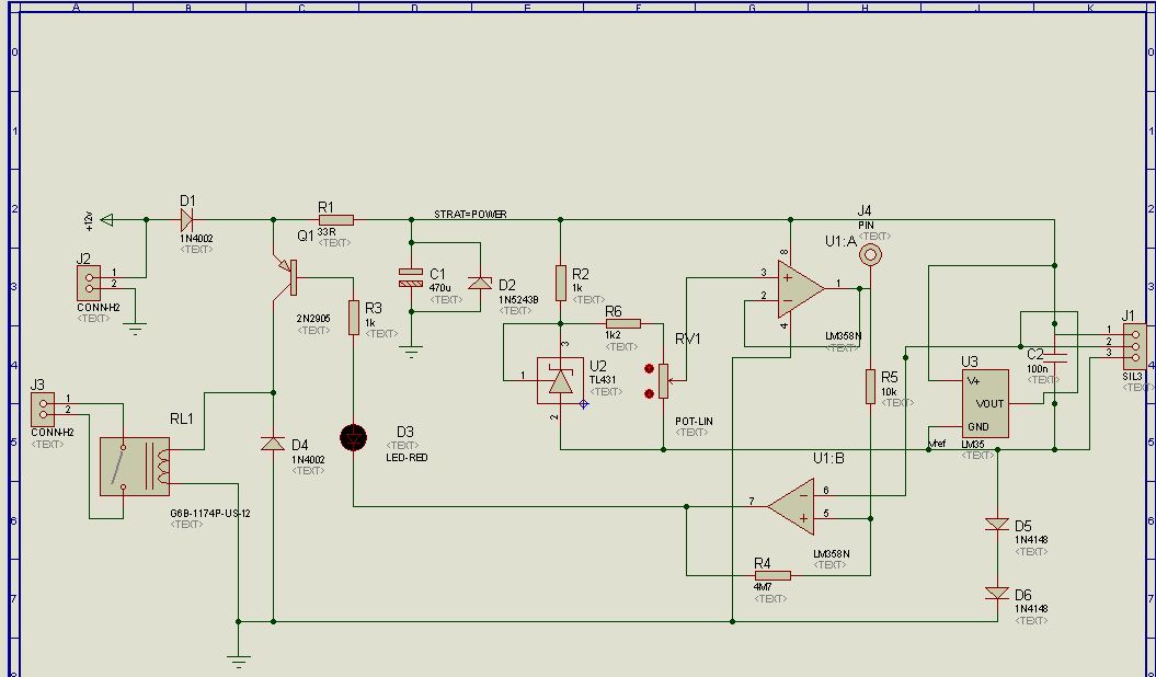

Hi everyone,
I have built a temperature controller. However, I wish to add some time delay for the relay to trigger off.As when the temperature drop to the boarder line, the relay will turn on and off in high speed.
So,what should I do to make 10 secs of time delay,so the temperature will be more "stable"
Attachment is my circuit design

R4 the 4.7meg hysteresis resistor is too high a value, try a 100K thru 1meg.
There is a resistor missing at the non-inverting input of opamp U1B. The required hysteresis is normally derived across a voltage divider. The bottom leg of the divider is missing.

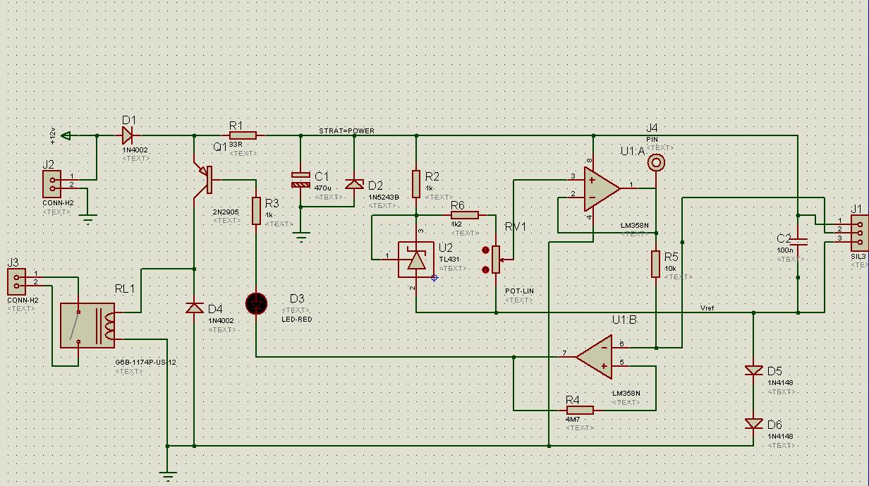

I will try to replace 4.7Mohms resistor to 100k tomorrow,but I have try with 1Mohms...it doesnt like it(it wont trigger off the relay even when the temperature different for 2 degree celcius)

There is a lot wrong with this circuit. There is no value of R4 that will fix it.
The root cause of your problem is how you are supplying power to the opamp. The current that flows through R3 (~10mA) also flows through R1. The drop across R1 causes the voltage out of the LM35 to jump as the opamp switches, causing the instability in the relay.
I do not understand why R1 and D2 are there. They are not needed.
I do not understand what D5 and D6 are supposed to be doing, except causing the output from the LM35 to be erratic.
I do not understand the function of U1A; it is not needed.
U2 should be set up as a 5V reference with respect to ground, and used to regulate the voltage for the setting pot as well as the LM35. Only a single opamp is needed. The hysteresis around that opamp should be about 0.5% of the output swing.

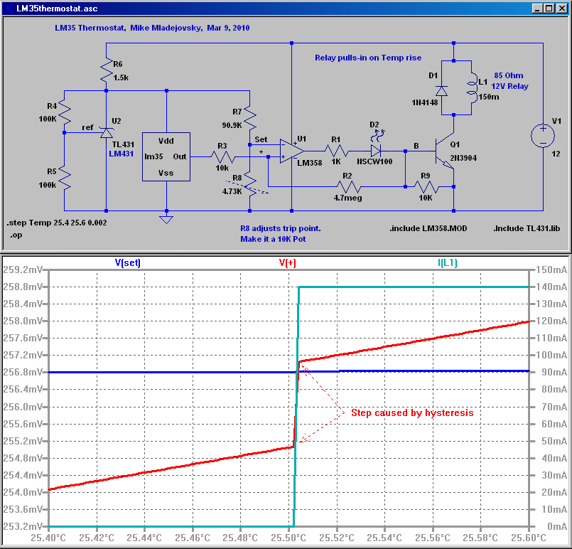

Here is what I cobbled up. I think it fixes all the problems. Note that everything that matters is powered off the TL431 (~5V). I varied the supply voltage from 10V to 15V with no detectable change in the trip point. Note the tricky way the hysteresis is determined. The voltage at V(B) is clamped by the Vbe of the NPN transistor, and that is what determines the amount of positive feedback. Doing it this way makes it independent of supply voltage.
By varying R8 from 0Ω to 10K, the temperature set point changes from 0degC to 50degC.
Relay picks-up on Temp rise; if you need it the other way, use another transistor as an inverter, or just wire the load to the normally-closed contact on the relay.

Repost the correct/latest screen capture of your circuit.

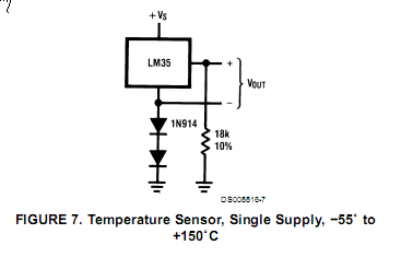

The basic LM35 works over a tempr range of +2C thru +150C, by adding the diodes the working range becomes -55C thru +150C.
The 18K shown in the App is required, the OP is not showing this resistor. The Vout is then taken across the LM35.
Ref LM35 App.
The circuit shown in your LTsim will not work below +2C.

well,I need to set the temperature as low as 5 degree celcius..
however,ericgibbs,I have changed the resistor to as low as 470kohms.
but it still trigger on and off frequently when the temperature reach the borderline..

Hi there,
The two diodes D5 and D6 are there to provide a pseudo minus supply voltage for the LM358. Without a negative supply the output of the op amp can not reach down as low as 0.000 volts, but may only make it down to 0.050 volts or so. Since the output of the LM35 is about 10mv per degree C, at 5 deg C the output will be 50mv which is already as high as the op amp output could reach without a minus supply voltage and without any hysteresis. With the minus supply voltage provided by the two diodes, the op amp pin 1 output can reach down below zero volts which means it can be adjusted as low as needed even with the added hysteresis, which of course means pin 1 has to go even lower (about 33mv) in order to adjust for 5 deg C.
The secondary effect is that the op amp output at pin 7 can also go lower than zero volts which provides a little better hysteresis.
With the output at pin 1 adjusted for a trip point of 5 deg C, after the trip occurs the temperature would have to drop to about 3 degrees C in order to turn the relay off again. That's only 2 deg C of hysteresis which may or may not be enough for the app itself, as well as probably not enough to get past the effects of noise from the relay when it switches.
One fix for this may work that is not too hard to do, depending on how bad the environmental noise is. Right now the circuit has only DC hysteresis which works ok most of the time, but for these tight settings we may have to add some AC hysteresis too and that may help a lot. The simplest way to do this would be to connect a capacitor of 100uf in series with a 10k resistor, then connect that series combo right across the 4.7M resistor with (+) terminal of the cap at pin 7 of the op amp. The cap will charge up to around 8v, then when pin 7 goes low it will pull pin 5 down very very low which will keep pin 7 low regardless what the LM35 does after that (such as it's reaction to the relay noise). The cap will discharge after some 1 to 5 seconds which will allow
the op amp to be ready for the next time the LM35 output goes lower and trips the lower set point. Once that happens, the output will again go high which will force a rather high voltage at pin 5 which will keep the output at pin 7 high for that same time period of 1 to 5 seconds, after which it will again allow normal operation.
Note that this is something to try and cant be guaranteed that it will work because it depends on the other noise factors too.
A second additional fix may come from filtering the output of the LM35 with a 75 ohm resistor in series with a 1uf cap with the cap to ground and 75 ohm connected to the output of the LM35. That will help reduce noise transients from the output of the LM35 when the relay switches.

The LM358 output will swing within a few mV of its Vss pin (ground), which is not even a requirement for my circuit. It has an input common-mode range which includes ground (actually up to 0.5V below ground), so the circuit I posted will work from 0 degC on up... It will work with a tiny (~2mV) of hysteresis, which is only about (o.2degC). I specifically tried to make it as bulletproof with respect to the relay switching transients (note the source of the positive feedback) as possible by referencing everything in the circuit to Gnd (not Vdd like in the OP's circuit). I'm relying on the LM358's PSRR so that its supply voltage does not have to be regulated. I notice that I forgot to show a bypass cap across its Vdd/Vss pins.
